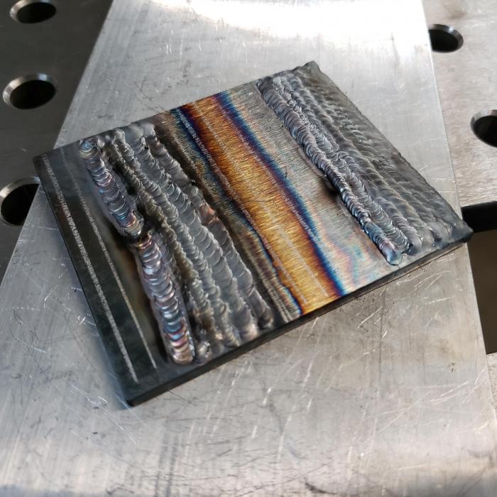

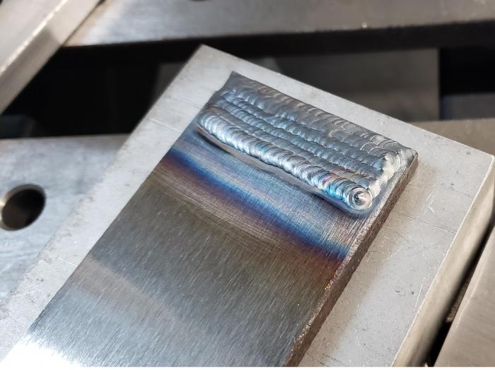

Hello All,
Novice tig welder here trying to gain some skill when I have time.
I've been practicing today at my shop.. My only reference point for what to strive for is what I've watched in Jody's and other videos online and a practice session a while back with a welder I know.
The lap joints are 3/16" thick cold rolled steel, and the padding block Is 3/8" thick hot rolled that I sanded the skin off of.
filler rod: er70s-6
tungsten: 3/32"
#8 cup with gas lens
approx 18cfh argon
dynasty 280dx with pedal
I was running the lap joints at 160 amps, and 180 for the padding.
I'm not even close to being able to feed the rod well during the pass as it just feels like there's too much going on to have the dexterity, although I'm trying to practice this. I pretty much just dab with it pinched between my thumb or fingers.
any advise or feedback would be appreciated.. other drills or methods to practice would also be great to know. :)

Welcome! Looks like a good start!

Your lap joints look just fine. The trick is to keep the filler/puddle from taking off the top lip. Think about keeping your tungsten pointed at a 45* angle right into the root. Then add filler to increase the puddle size. Without filler, you’ll be melting the base metal/vertical side already, so filler just reinforces the root.
If you take some practice runs so your torch arm is very lightly resting but able to slide along the joint, you’ll do better. Feeding filler takes time to develop the dexterity.
Your padded beads look really good. For the practice, they’re absolutely fine. But the actual heat used was a bit low as witnessed by the edges of the last bead. See how it wraps underneath? You ultimately want that wetted into the plate. Don’t fret right now on the total amps needed, just develop your skills (like you’re doing).

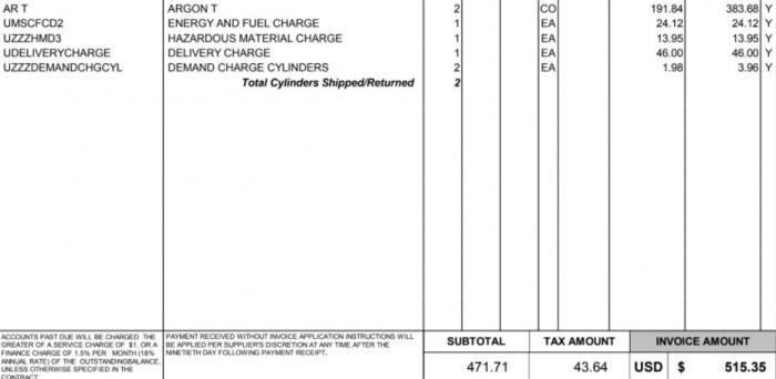

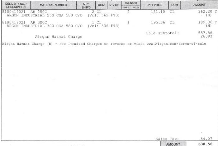

For argon, last time I went.. It was $181.00 ea for 2x 250's, $195.00 for a 300 plus hazmat and tax. So I paid $638 for 3 big bottles to be filled. all customer owned.

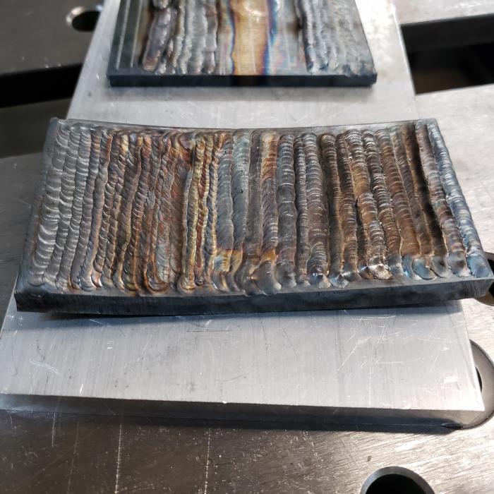

Thanks for the feedback and insight,
Makes total sense.. Developing the skill and dexterity seems to be the big hurdle, I spend the day turning the 3/8" chunk of steel into a potato chip --> dunking it in water after every third pass. through repetition I'm noticing things, but it's really hard to just relax and not rush the dipping and relax the torch hand. Once I start a bead my arm just seems to get heavier.. lol

Most of what we make at the shop is stainless.. So my natural instinct is to be wary of excessive heat input, I'm not a welder but I'm trying to learn so I can be when needed.

Just about everything here is inflated in price.. Including wages and rent.
But admittedly I haven't shopped around. I'm sure I could find a cheaper gas supplier.

Those beads look very good for a beginner, I really don't think I need to critique anything besides that they look a bit cold, I like my ripple pattern to look fairly blended. What size filler rod are you using for padding?

I was using both 1/16" and 3/32" and I don't recall which rod diameter I was using when I was running the padding.
I appreciate the perspective from you and another comment and I'll try to focus on the bead wetting into the plate more.
My natural instinct is to not overheat material as we spend a lot of effort at my shop keeping stainless from turning grey.
I've never seen an example of an ideal run of padding, so this feedback is really helpful.
