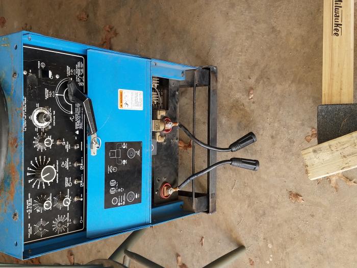

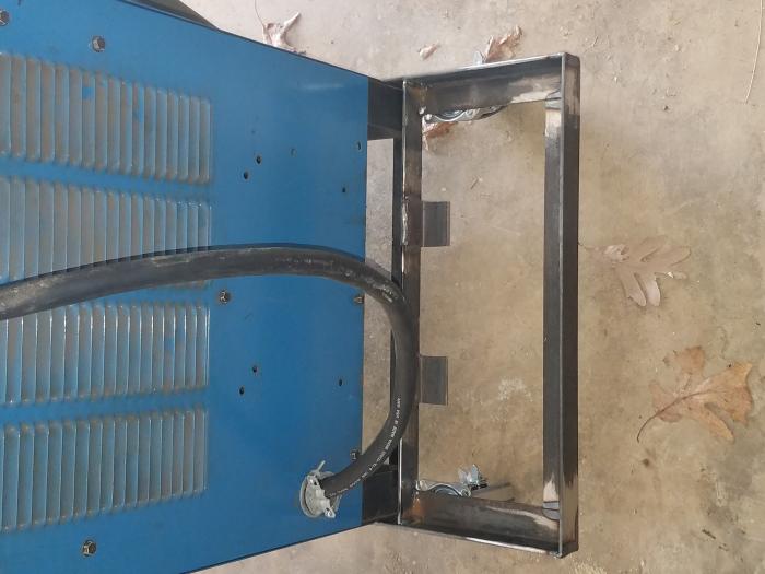

I started to build one for my synchrowave and never finished the gas cylinder arrangement. But angle iron and casters are your friend. That's 1.25 inch angle iron, supporting a 400lb welder, no problem. The small casters work fine on my cement floor.
syncrowave 2.jpg (42.28 KiB) Viewed 1352 times
