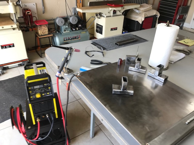

Square Tubing (11ga, 14ga, 16ga, hot rolled), is driving me crazy. I'm all over the board trying to find a 'sweet spot'. Here's what I got, for this I'll use 14ga:
Hot Rolled 1"x2" - 14 gauge that measures 0.073" Cleaned and shinny.
Tungsten: 2% Lan, 3/32", 30 degree grind.
Cup Size: #7. Normal #7 stick out for sides and stick out for #8 cup on the T-joints.
Argon: Sides 20 cfm, Tee Joints 15 cfm. No pre-flow and 5 sec post.
Fuller Rod: 1/16" ER70S-2.
Amperage Setting: 65 for sides and 73 for the fillets. Using Pedal. (I've gone up and down)
I'm trying to get my TIG game going at least as good as when I MIG'ed this same stuff,,,,, BUT. I'm not gonna to give up....
Any pointers???

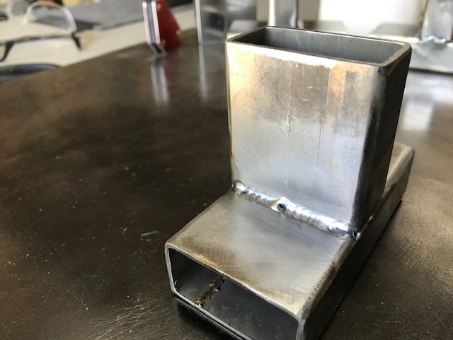

The fillets don't look too bad, just a couple of spots. Remember to keep as tight of an arc that you can, also the end of the tube should be clean as well, contaminates can be pulled into the weld if it's not.
I would recommend at least a 0.3 sec pre flow to ensure the arc is started with shielding, also if the tungsten is discolored when you finish then a longer post flow is needed, not much maybe 8 seconds.

i think your amps are way to low (on the corner joint)Burning Filler Rod wrote:O'Most Knowledgeable Ones,,,,,

i don't do much in the way of tig on steel but calc says 80-120 amps. i would set it at 120 amp and then you can drop it as required.
you can tell its cold as your only heating the side of the joint and not getting down into the root. grind angle of the tungsten will effect it to.
you need to get it to puddle in the root, use plenty of amps and increase travel speed.
I agree, likely you are feathering the pedal and not realizing it. We can't see through your eyes, but make sure you can see the puddle and just barely distinguish the tip of the tungsten. This will go a looooong ways to keeping a consistently short arc.
We didn't see the arc while you were welding, and you didn't describe it. I bet it was not always going into the root of the joint? Was it favoring one part or the other? Do go ahead and describe what was going on.
I would preflow and a bit longer post as others stated. 20cfm is way too much. Try 20cfh. Lol. Sorry.
Looks ok. I think you need to just get more practice for consistency. And i would use higher amps. Especially on the filet. Miller has a good calculator you can use for free.

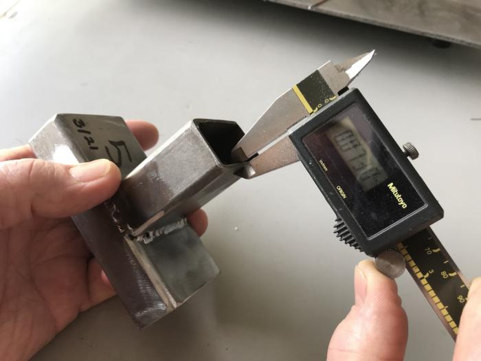

In a perfect world a 2"X4" would measure just that and 3/4" plywood would also measure 3/4". Ahh but, we do not live in 'Oz' where all is in color and wonderful.
I do use a very good vernier caliper. I reset the 'origin' often due to it's sensitivity in changes of daily temperatures. (See Below)
I purchase my hot rolled steel in Florida and it always checks less than is stated in the metal tables. I do use the '0.001" rule up to about 1/4" steel and apply that rule as a 'starting' point.
Remember that I'm just starting out learning GTAW. So, lots of my welds, (fillets, butts, laps) I can't do at fast travel speeds or proper amperage like you folks. Heck, I'm lucky to find the pedal let alone modulate it.
Thanks for the input and know I am not a quitter.... Semper Fidelis..!!
