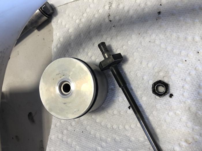

Good evening,
I discovered that I need to have possible TIG repairs made to a nose strut metering pin's threads. In the nose strut at the FAA shop, I see that the threads have been damaged by age, corrosion, someone forcing the nut off rather than using finesse. At this point, its anyones guess as to what caused the threads to strip.
Since the cost of the part is absolutely ridiculous, at $3800.00, I am curious as to the possibility to replace the missing metal via a TIG repair and then have the threads re-cut. Any FAA certified welders care to weigh in on this and any recommendations where I can have this done?
Thanks for taking the time to read my post.
Cheers
Trevor
1967 Cessna 150G
Damaged threads
Damaged threads
OLEO strut base plate and metering pin

Call me chickensh^t, wussy, etc........I wouldn't touch an airplane part with a 10ft torch. Guys that are certified, etc, they still must worry about the "what if" factor. Dunno, maybe it's just me?

Last I heard, FSDO and GADO FAA maintenance guys could not issue field approvals related to landing gear items. You will probably have to find a DER with the appropriate certs to write up a proceedure. Guessing the paperwork will cost about 1/2 as much as the new part.
I know when they had to write a new procedure for a boiler repair I did it cost a little over $2000. Because of the paperwork and the time to make weld samples that get tested for the certification process. Obviously not airplane grade but I’d imagine the process is about the same.
discap
    Sun Jan 07, 2018 1:52 am
There is no way a DER would sign off on that type of repair. He would need to know the exact composition of the bolt either through analysis or the original drawings. The part would need heat treating after re machining the threads. If it is off a 150 just give White Industries a call and get a serviceable used part.

Thanks guys for your responses. All very valid points. In fact, in looking closer at the part, I am thinking the top has been machined at some point in its past. Color difference and a beveled edge where every reference I have pulled on line doesn’t have that particular cut.[emoji848]
The hunt for a serviceable part has begun.

Luckily, I just found a viable replacement at our local aviation wrecking yard. Yup, we have one here is Sacramento. It’s the same yard the Mythbuster team got all of their aviation items for all the aviation myths. Chicken gun, spiral cut wing, etc.
Anyway, for the most part, it’s identical with the exception that it’s about 1/4” longer. Although, in taking a closer look, it seems that my original might have been machined sometime in its past. It’s all about the journey, right?
Looks like the original might have been machined a bit.
Original
Replacement

Possible it was just a part change as time progressed.
JT68912
    Thu Feb 14, 2013 4:10 pm
That is exactly what happened. In reading through the service manuals for the 100 series aircraft, our particular year was where they made some changes. Literally the prior year had two possible setups and with the 1967 year, shortened the metering pin slightly as well as changed the small collar at the very bottom just above the large hexagon nut. In cross referencing the actual part number, I was able to find a single image of a pin being sold from the Texas Air Salvage that showed the same beveled edge.
I located at precision machine shop here locally. When I visited, I was surprised at the size of the operation as well as the machinery. The name is Airpoint Precision. In speaking with the lathe dept manager, he has a tech that is an A&P and will have him turn it down after looking at the pin.
Fingers crossed[emoji1695]
dgapilot
    Wed Jul 26, 2017 7:00 pm
There’s got to be plenty of 150Gs in salvage yards to get the right part. A better bet may be to get the entire strut. When I’ve seen airworthy 150s go for $10k lately, you could buy a whole plane for not much more than Textron wants for that part.
All that said, welding that up with 309 wire and turning new threads wouldn’t be a big deal. Not much pressure in the 150 nose strut. The question is have, were the threads cut or rolled? I don’t think I’d have a problem issuing an 8110-3 for it.

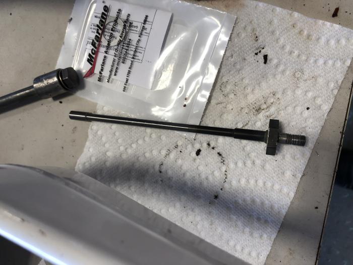

Picked the part up and they were able to machine everything to the specks I asked. I presented the part to the A&P resealing the nose strut and he then proceeds to point out another area that need to be milled .03” and tells me it will have hydrologic lock if it’s not corrected.
Original on the top, machined part on the bottom.
Machined collar on replacement part
Original collar
Ok, I get it, but I honestly feel he is now F-ing with me because it’s a point not consulted with on his first rejection. Another delay of two weeks. All I ask it tell me everything that needs to be addressed. He then attempts to lecture me how “us” airplane owners want to save a buck. Seriously, on a $3,800.00 part that his shop mongoed off rather than properly loosening the nut. Which I can not prove.

Keep in mind that when an A&P IA signs off on your aircraft he is taking on a significant amount of liability/risk. He has no control over what Textron charges for a part, and under Part 43, he is required to install parts that are “airworthy”. To be honest, installing the modified part without engineering approval to him is a risk. Each A&P has his own level of risk acceptance. Be glad he is even willing to use the modified part without a DER approval. He could well have said the right part or no signature.
