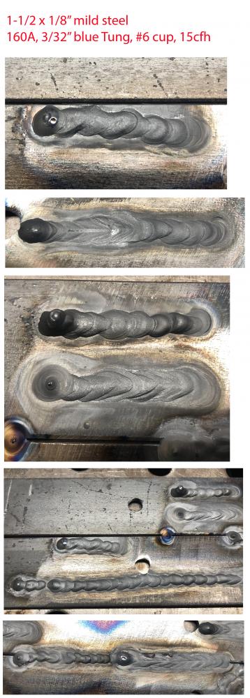

I tried some mild steel and strangely enough the welds look narrow and ugly, although the penetration is good. It almost seems like aluminum is easier, at least when it comes to laying learning beads on a flat plate. I also did a butt weld which seems sound, yet butt ugly.
day 5 mild steel.jpg (77.14 KiB) Viewed 1705 times
The puddle seems narrower, and I have to walk the cup in a circular motion to widen it before the filler. Am I setting the tungsten up wrong: poor angle? Too blunt tip? Using an ArcZone Sharpie DX.

Don’t blunt the tip. Lower your heat (125amps), get and use a gas lens for cups larger than #5, and try a larger cup (#8 is my go to).

I welded some 1/8” mild steel brackets to 1/16” tube last night, as I am building a cart for my offcuts. 80 amps, #7 cup, 2% lanth tungsten. Image

Looks like you need to bump amps up and tighten up your dabs. Possibly move faster also. Just my opinion.
cj737
    Thu Sep 29, 2016 8:59 am
I think your amps are fine, but on the second picture, you dipped kind of heavily. The first picture looks rather tidy in my opinion.
What size filler. On stuff that thin I’d be using 1/16 or 3/32.

Poland308 wrote:What size filler. On stuff that thin I’d be using 1/16 or 3/32.
1/16”
