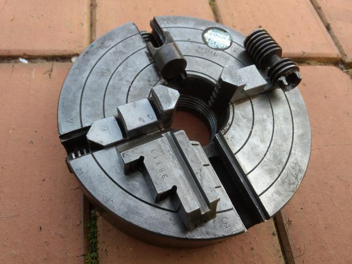

I've picked up a 'new' lathe, ex school, with a bit of damage here and there. The Pratt Burnerd 4-jaw chuck has damage to 2 of the 4 jaw adjustment screws.
The plan is to clean these and then build up material before turning off the excess and hand finishing. Any tips on which filler? Silicon bronze? 309 stainless?
All tips appreciated!

Check with the manufacture of the chuck to get replacement parts. If you build up the side of the screw with weld how are you going to broach the square hole? If you have the side piece I would use silicone bronze rod.

I recon you could get another one from the chuck manufacturer. Personally I'd sink my money into a three jaw self centering chuck.
My only concern would be cyntrifical forces at play when there is a heavy or long object in the chuck.

If you are dead keen to tig repair these cast screws, I have had excellent results with EZ Weld Tig Wire
https://ezweldtigwire.com/
You can order some in, it's strong as. If you build it up I suppose you can use a small 3mm pointy burr to get in and shape the square hole.

Dipper, the parts are available...but I am seeing $50-ish EACH for those screws. If I repair, I'll get into the hex with a tiny carbide bit on my Dremel to make the best hex fit I can.
Coldie - I already have a 3-jaw self-centring chuck, came with the lathe along with a bundle of other stuff. (Did I mention that the lathe in great condition, plus all the other gear...cost me a carton of beer?)

Some flat machinist files will enable you to broach those hexes back into shape. Going to require a bit of "doing", but can be done. If you have a hydraulic press, you can buy the broach yourself and just do it that way. Or, you can make a broach and do it yourself.

Thanks for the tips, and hey, all the DIY work is no problem...I have many, many hours of work ahead of me as I set up and get to know my new lathe, so this repair is no biggie. Funny thing is, no matter how difficult and time consuming the repair might wind up being, on principle I'm simply not the type of person who will pay $50 for a single adjustment screw!

I would grind a brass rod or bolt to a square shape to fit the screw. TIG weld the missing area, letting the weld lay against the brass. I would make the brass sure slightly undersize to facilitate it's removal. Good luck !

If you can get piece of aluminium square bar to snug in the hole while you build it up, the job will get a whole lot easier. :D

I like the idea of the square aluminium backing bar - perfect!
Have also considered lopping the hex off a Allen head bolt, grinding the end of the old screw flat and welding the hex to the screw.
