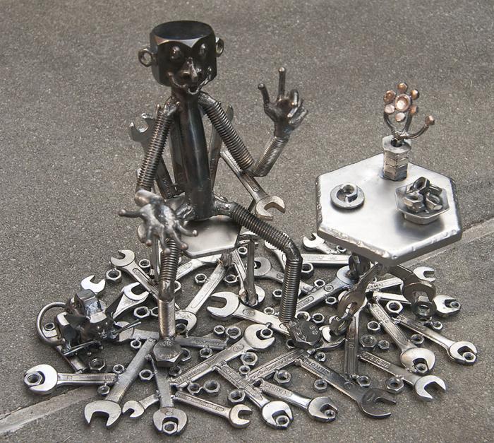

Just a little fantasy piece I have been working on for the past week or so - "The World is Nuts" - not quite finished. ;)

Good job. All though I won't let you get close to my tool box.

That's pretty sweet how do you make the hands there almost anatomically correct

Mike,
The hands are the hex-heads of those bolts, sawed off and welded back on end-wise (at the appropriate angle). The fingers are made from sections of large carpenters finishing nails. I did some low-amperage long-arcing to heat them to the point where I could easily put a bend into 'em, then cut out the curved bits that matched what I wanted and welded them on. The rest of that is simply built-up work, melting it all in as I went. I just kept adding on until it seemed right. In general, just lots of patient work.
PS I cheated and looked at my own hands for shape and pose. :D

Grab some tweezers and crank the welder up to warm nice work
