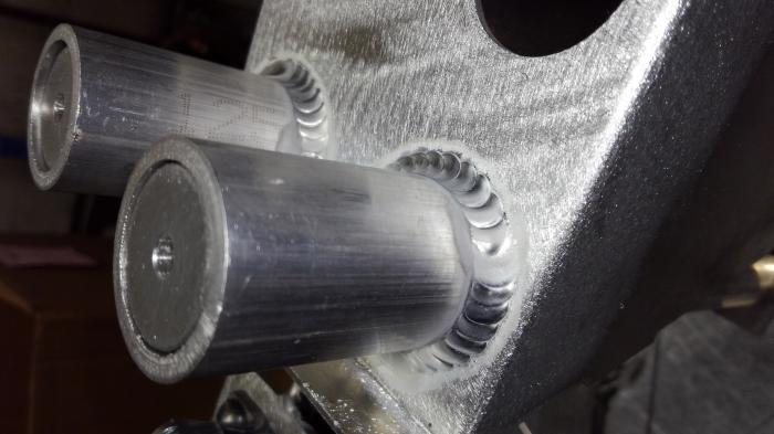

Anyone have some good advice for welding tubing 2" to 4 or 5" and round parts without a positioner? I really struggle getting a good position in tube, and can only go about 1.5 inches at a time without having to reposition.

Practice practice practice! It’s been a while since I’ve walked the cup but when I do I like to start at the 6 o clock potion and work up and around. Usually only have to reposition once or not at all depending on if I have room. I’m sure there are others that can give you some better pointers but that’s what I got.

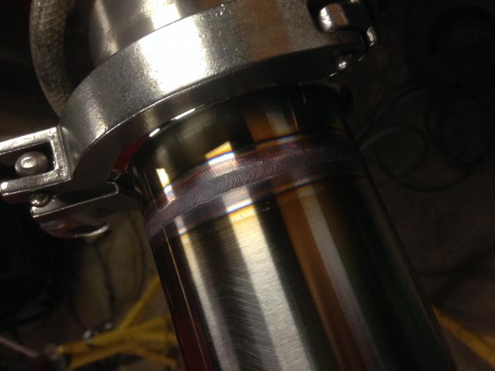

The absolute thing that people new to welding need to be taught is that, unless you are walking the cup or welding big plate and pipe, you don't very often go too far with out stopping.(Instagram does not help with this at all) On big items, you can prop or rest the cup and a few different tricks, but you do not need to become a welding genius that can weld for a mile. Look at this picture, each of the distinct heat marks is a stop start. That's the beauty of tig, you can make a restart at any point with ease.

This. It is ALWAYS best to be in good position versus welding farther. Welding out of position will produce poor results unless you are an immortal and professional who has become experienced at it.weldin mike 27 wrote:The absolute thing that people new to welding need to be taught is that, unless you are walking the cup or welding big plate and pipe, you don't very often go too far with out stopping.
Since this is not production welding, take your time and weld it comfortably. If you do weld, stop, re-positon on small tube, I like to rotate the part in "quarters", not just keep advancing the last string. If I rotate the tube/pipe 90* each time I stop, I personally get better results where I can ultimately connect my strings with a couple of beads washing into the "start" of the next piece I'm connecting to. It helps blend all the strings into a more "singular" looking weld.

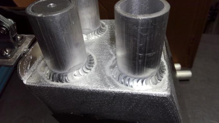

Hardest thing about anything round is teaching yourself to constantly make adjustments to your torch angle as you go around the the tube or pipe. The smaller the tube the harder cause adjustments have to be made faster. I would get yourself some bigger diameter stuff and practice. Positioning really depends on the part and thickness. If its thick I like laying it horizontal and going for bottom to top. But on thin stuff I prefer flat position up off the table so it's easier to make to adjustments and you can talravel farther. This little 1.25 did aluminum took me awhile to get down.
- KIMG0059.JPG (37.04 KiB) Viewed 4735 times
- KIMG0060.JPG (34.29 KiB) Viewed 4735 times
I always do some dry runs trying to find find how to best hold my wrist/torch to get the best torch angle I can as I move. A light touch on the torch is key and it won't be long before you are rolling the torch in your fingers to keep that torch angle. Lots of practice and a good plan on how you will manipulate the torch will get you to where you want to be.
