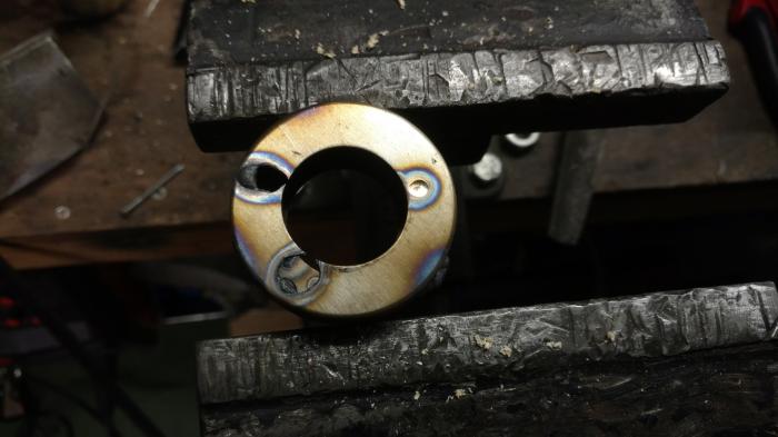

Strange thing today on my welding. I had some stainless door handle covers about 1 1/2" in diameter and 1/32" think. A bit like a thin walled bushing.
I thould it would be a good thing to weld them together to get some practice.
I can't say it went verry well. But i found out that a setting on my welder (Arc force) had influence on my tig welding. I thought (and read it in the manual) that it is a setting for stick welding.
The two holes are made with a second of arc power with everithing as low as it goes. th (accept arc force) The little dot is made acr force also as low as it gets. This way i can "weld on the 1/32 stainless. With the arc force high it's verry difficult.

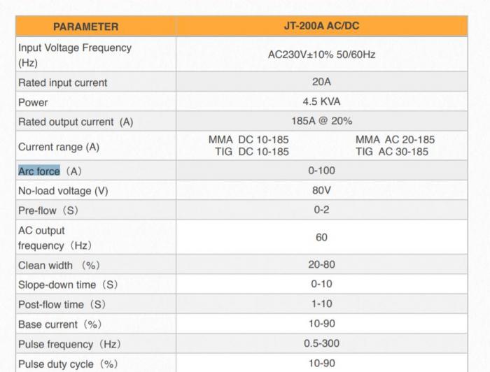

Anybody the same experience with there machine? Or is it normal? I placed some pictures of the holes and spot and the machine and manual.

Hmmm...I was under the impression that ARC force was something that was only done for stick.
I'll try adjusting mine, I had it set around 30% when I was tigging yesterday.
My machine is marked 'Stick" on the panel for ARC force. Maybe it depends on the implementation by the manufacture, but I don't think mine is active during tig.
I think it would be bad for tig to have ARC force as it compensates for low voltage when the arc gets short. With tig however, most people control the amperage with the pedal. I'm confused...
My TA 186 automatically bypasses the arc force in tig mode. But other machines I’ve used it did make a difference. Can’t remember what difference it made but I know some machines tell you to leave it turned all the way up or down depending on the manufacturer.
