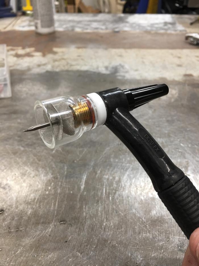

I have to agree with CJ; a #8 lens is the way to go. The clear glass lens, bought from Jody's website, will illuminate the weld and help you see better. At least for my old eyes. I use this for 90% of my welding.
- clear lens.jpg (74.13 KiB) Viewed 8181 times

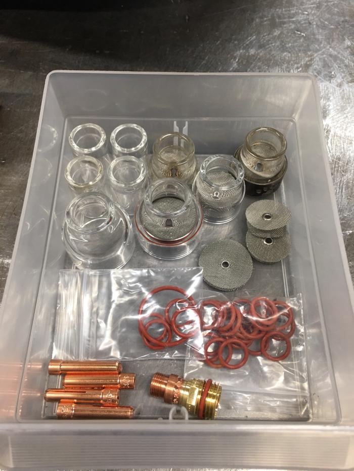

I like to have a little bit of everything for odd jobs so I have a range of cups for gas lenses I use my 8 most oft e time and go up from there depending. If I were you I’d do the same, no sense in putting all your eggs in one basket. I too use the Furick cups and I am very happy with them but you cannot weld aluminum with them so far that I use the standard pink ceramic cups.
- 5A91C159-8FDD-4497-A416-C944C4EB95F9.jpeg (70.96 KiB) Viewed 8172 times
- 81B73E0B-0351-4513-ABE0-463CE3F7640F.jpeg (74.76 KiB) Viewed 8172 times
- 1C321062-41B1-4472-BF45-9F35C1A278A4.jpeg (64.19 KiB) Viewed 8172 times
- 092E8B26-7963-495D-8365-74E7E4F169A0.jpeg (92.46 KiB) Viewed 8172 times
Let me rephrase, most Pyrex manufactuers recommend they not be used for aluminum. Can you yes, I have but I want mine to last so I use the standard ceramic for aluminum. To each their own.cj737 wrote:You can weld aluminum with Pyrex cups. You cant walk a Pyrex cup on aluminum because they will crack.
Interesting that you use Furick cups but shy away from using them on AC. Especially since all he does is use them, particularly on AC.Graveyard wrote:Let me rephrase, most Pyrex manufactuers recommend they not be used for aluminum. Can you yes, I have but I want mine to last so I use the standard ceramic for aluminum. To each their own.cj737 wrote:You can weld aluminum with Pyrex cups. You cant walk a Pyrex cup on aluminum because they will crack.
https://furickcup.com/product/8-pro-cup/
cj737 wrote:Interesting that you use Furick cups but shy away from using them on AC. Especially since all he does is use them, particularly on AC.Graveyard wrote:Let me rephrase, most Pyrex manufactuers recommend they not be used for aluminum. Can you yes, I have but I want mine to last so I use the standard ceramic for aluminum. To each their own.cj737 wrote:You can weld aluminum with Pyrex cups. You cant walk a Pyrex cup on aluminum because they will crack.
The larger ones he doesn’t so I assumed the #8 cups fit the same description. I guess I was mistaken.
That’s because there’s not really a needed application for a 12/16 cup with aluminum like there is for Ti or Stainless; which is the intended market for his Fupa, Moose and BBW.Graveyard wrote: The larger ones he doesn’t so I assumed the #8 cups fit the same description. I guess I was mistaken.
Even so, you can use them for ally, but why would you? You just don’t need that kind of coverage.

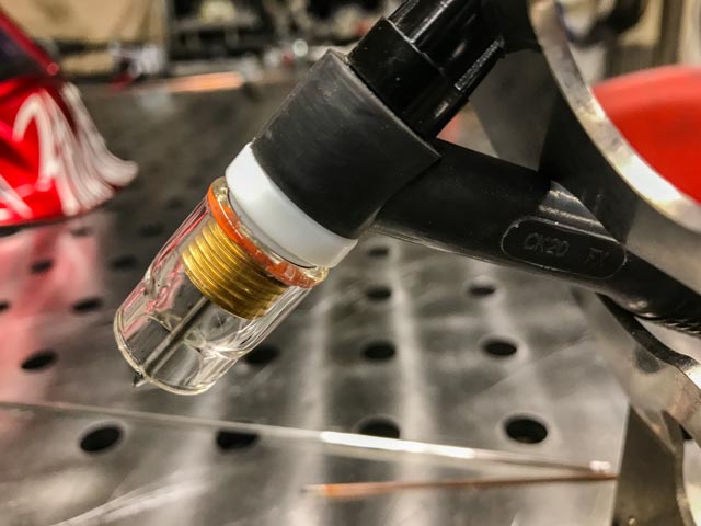

For ally welding I use a 5 or 8, 3/32” for most of it. 1/8” tungsten when thickness demands.

Basically, if you can't use a 3/32" tungsten to weld very thin material, then you are doing something wrong

A #26 is essentially a larger bodied #17 torch, rated for 250 Amps. If you're running that high of amps, you might re-consider a water cooled setup. You might...
I use a #5, a #8, and a #12 cup. The 8/12 I use the same 3/32 stubby lens from Miller. I only switch to a "jumbo" or long-nosed lens (still 3/32 and #8 cup) for TIG welding pipe of >4" OD. Easier for me to walk the cup around.
I'm a huge fan of the Furick Fupa cups, and use them in Clear (5, 8 and 12) for aluminum and stainless. I also recently grabbed his ceramic 12 and have been very pleased with it for DC welding where I want the coverage, AND want the contact.
You probably also want an 1/8" lens, but the Fupa cups won't fit a 1/8" lens setup, only 3/32. I've spent way more money on cups in every darn size than I'll ever use, only to find a "sweet spot" for me in these 3 cups. Sure, I've come across a situation where a long-nosed 4 would be perfect, but I work around those situations with a larger cup and longer stick out now.

The #8 cups are just a gas lense with a Pyrex type cup. If you look at the #12 in Jody's store-he warns that the diffuser can arc out on the #12. That is why you shouldn't use them on AC. Them #8 doesn't have a diffuser.cj737 wrote:That’s because there’s not really a needed application for a 12/16 cup with aluminum like there is for Ti or Stainless; which is the intended market for his Fupa, Moose and BBW.Graveyard wrote: The larger ones he doesn’t so I assumed the #8 cups fit the same description. I guess I was mistaken.
Hello everyone!
I bought all the parts that I wanted.. (some I will most likely never use but if I need them, I'll have them and won't have to wait weeks to get them in the mail)
On a side note:
