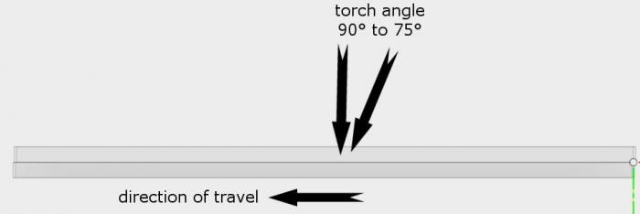

That along with the nearly 45° angle new tig users tend to use. Torch angle is critical because even if you do have a puddle, extreme torch angle will still melt the filler away. Gotta stay less than 20°from the vertical.

Oscar wrote:That along with the nearly 45° angle new tig users tend to use. Torch angle is critical because even if you do have a puddle, extreme torch angle will still melt the filler away. Gotta stay less than 20°from the vertical.
- What Oscar said + keep as tight an arc as practical
- dot.jpg (10.95 KiB) Viewed 6530 times
