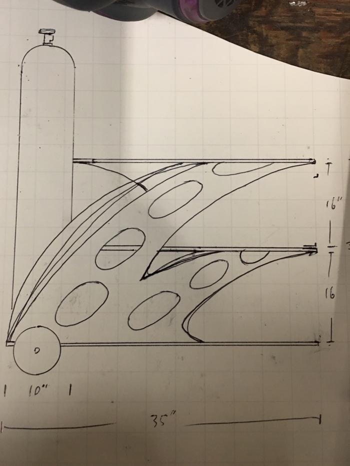

Well I decided to build my own welding cart. I needed 3 shelves and I just couldn’t find one I like that fit my price range so I just designed and build my own. Still have to add a few things but here it is!

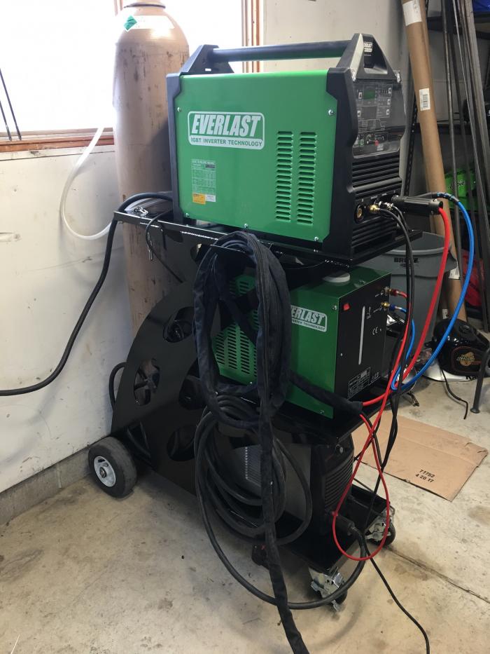

The cart isn’t done but here is the new setup it was built for.

Finally finished the cart off with some lead hangers and a paint job.

The cart is 13 1/2” wide not including the hangers. With the wheels on it is 38 1/4” tall, each shelf is 16” apart. I built the shelves out of 3/4” square tubing and welded the 1/8” plate inside of the Square tubing making kindof a tray so that if for some reason anything shifts it won’t fall off. The sheet I used to cut out the decorative sides was 1/8” pickle oiled hot rolled steel. Basically the same as hot rolled but they dip it in acid to remove the slag so it has that cold rolled shine. I went with it since it was as cheap as normal hot rolled but I wouldn’t have to do a lot of carbon clean up. It roles really nicely. I used Caster’s from northern tool and some pneumatic lawn mower wheels for the rear. Not including the tank it has about 110 lbs of equipment on it. I was worried with the design it would want to tip especially without the tank but it doesn’t.

Yes, I like that size Graveyard. I'm been pondering something narrower than 24" for a single tank, this looks stable.
What size tank is that, it looks like a 330cfm possible?

It is a “T” tank or 330 Cu Ft
