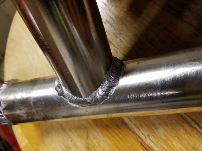

Got some anodized aluminum tubing from a friend to try out. I've welded a little plain aluminum before, not much, but he said anodized is difficult to weld. Looking for some tips, or baseline settings to try out. Its 1" and 1 1/2" tubing, looks like about .125 wall thickness. Any recommendations on technique or heat?

That is my 5th try, 140amps, 3/32 2%lanth tungsten 120hz, and about 35% cleaning. It just seems dirty, and cold. Whenever i get it to wet in it looks like one round bead instead of the way it looks on regular aluminum

You'll notice the anodizing is disrupted within the weld, and the "crispness" of his beads is due to the "bump welding" technique. Basically he uses a torch switch to modulate the heat to full on, off, full on as he dabs and travels. Takes a LOT of practice to achieve these outcomes.
You might achieve something similar by setting up PULSE on your Alpha. A low pulse rate like 1.2-1.4pps, 25% on time, 25% background, and move your amps up. Just tinker with the % on time, to see if you can get the timing down. And maybe Warren has some other better insights from his experience.

That is the brushed and its the easier one. Polished never looks good. I set my machine at max amps so I really cant say the exact amp setting you need. I use 1/8 cerriated tungsten, 75 percent electrode neg, gas should be at 40 cfh. Get a small ball on your tungsten. About like an ink pen. I use 1/8 5356
Start your puddle and make sure the anodizing is breaking down on both sides. I have had coworkers watch and they see 185 to 195 amps. Add filler and reduce the heat until the puddle freezes. Advance about 1/8 inch. Increase the heat until it is flowing and add filler, hold the heat until the puddle matches the last last ones size, repeat.
It will never look like bare aluminum. The anodizing contaminates the puddle. You will start seeing a stripe down the middle of your weld. You are pretty close when you see that.

I wanted to add that my work machine wont let me adjust the frequency but my squarewave makes better looking welds at around 120 hz. Im stuck with 60 at work.
This is from the squarewave at 120 hz.
