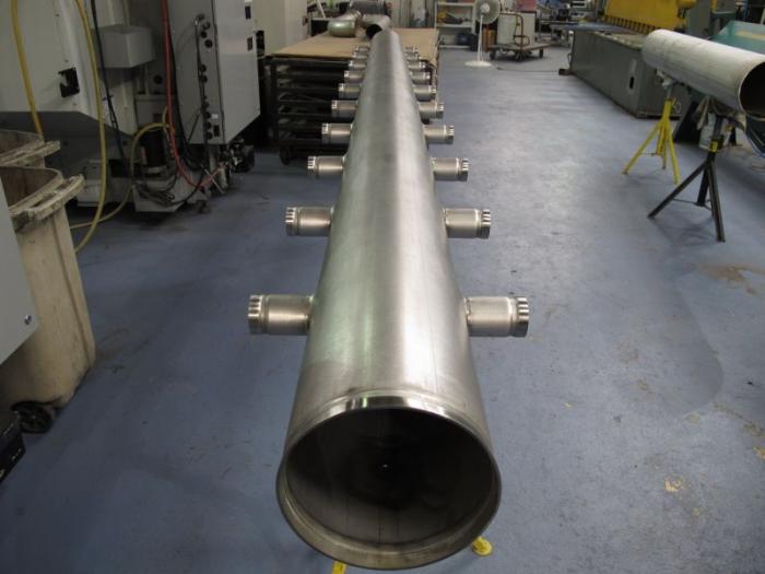

Makes sense, nice looking pipe spool
Last shop I worked we had a T-Drill machine that would pull the tee in schedule 10 stainless.
sch 10 316 with rolled victaulic grooves

Lt I don't have a ton of experience with ss, that stuff pull on you bad? I've welded sch 10 before, boss watched me like a hawk to make sure I wasn't going too slow when I was welding it
Donniev wrote:Lt I don't have a ton of experience with ss, that stuff pull on you bad? I've welded sch 10 before, boss watched me like a hawk to make sure I wasn't going too slow when I was welding it
Yes, it'll move easily. We use a level to make sure all the ports are true to each other.

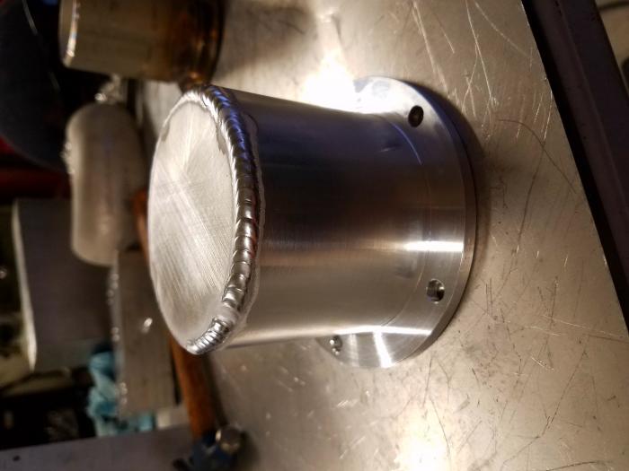

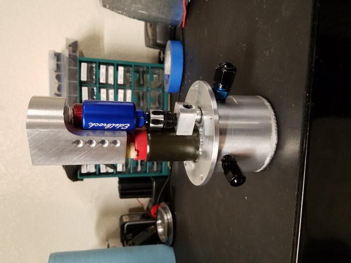

Also welded the bottom on a fuel sump that my buddy machined for his turbo bike.
@Oni
Nice looking welds and fab work

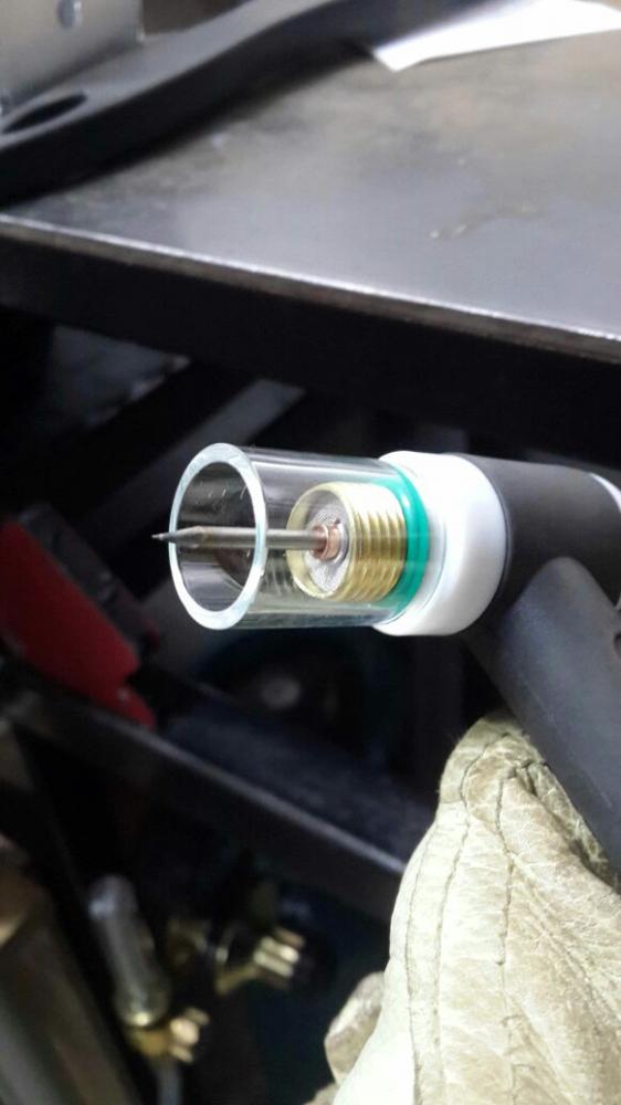

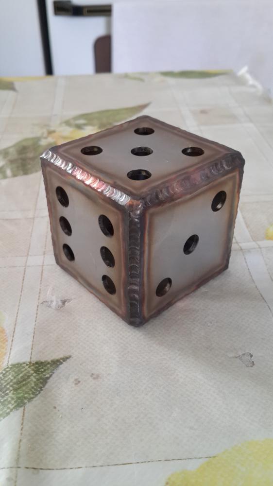

Hi all,
I lasercut a few more of the stainless practice cubes and tried an el cheapo pyrex gas lens.
I'm not sure if the increased coverage gave me less discoloration or if I was welding colder (or faster...). I tried to not remove too much of the material when welding.
I also added a max current control on my foot pedal which made the range more controllable.
It was really nice to see some pretty colours in the welds instead of the dull grey I have been getting.
I have my original cube and the one I did most recently. I don't think my filler feeding consistency is any better yet.

Certainly looks better, does your machine have the ability to pulse? You could use a slow pulse setting to help time the addition of filler and give a more consistent looking bead

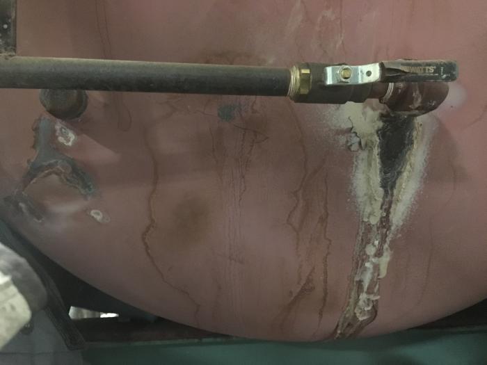

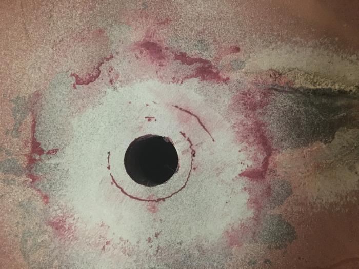

Last weekend. Pressure vessel repairs. Didn’t include all the photos but ground out an old coupling and welded in a new one. Plus made a repair on another pin hole on the coupling on the left. With the pt test you can see the stress crack that developed on the edge of the HAZ. Had to grind that out full depth as well. Beveled the base metal and the coupling. Then had to add a fillet per code so that I didn’t have to back weld from the inside.

Yes it does have pulse just haven't really had a chance to fiddle in detail with all the settings. My Argon and scrap supplies are running low at the moment haha.
I think it is almost time to construct something a bit more useful :)
