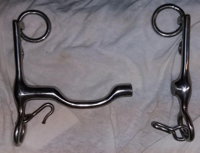

Hey all, recently started welding and TIG welding and have been trying to get some practice in. I don't nearly get around to it as much as I should.
Really see some amazing work being done here on the forum, truly incredible!
Some of the sides are not looking too good and I can only assume way too much heat on the stainless part :cry:
Have been struggling a bit with the stainless for some reason, I'm thinking my filler it too thick so I can't move as fast as I want to.
Hopefully I will tackle a more useful project soon, i.e. aluminium water tank for my car.
Also got my TIG finger combo, was pretty expensive to get it to me, but definitely worth it considering the wealth of knowledge that is available.

Welds look good from a consistency perspective, but way too hot. With stainless, heat control is a major challenge. A few fusion tracks to hold the sides together, then weld only one edge. Let cool! Then weld another edge elsewhere. Let cool! And keep rotating to farther edges. Stainless is terrible at dissipating heat, so patience and input control is paramount.
Maybe a smaller wire too for that project. It takes a lot less amps to weld stainless than the equal thickness carbon steel.

Thank you for that advice! I really didn't give this piece a chance to cool in between welds.
I think next time I should make a few of them at the same time, that way I can keep busy but also let them cool in between. I'm also learning that having little jigs or something to help you hold things is really important in making your life easier.

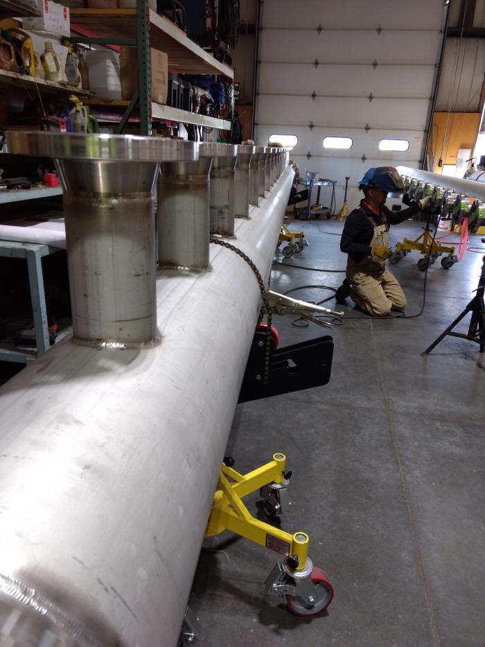

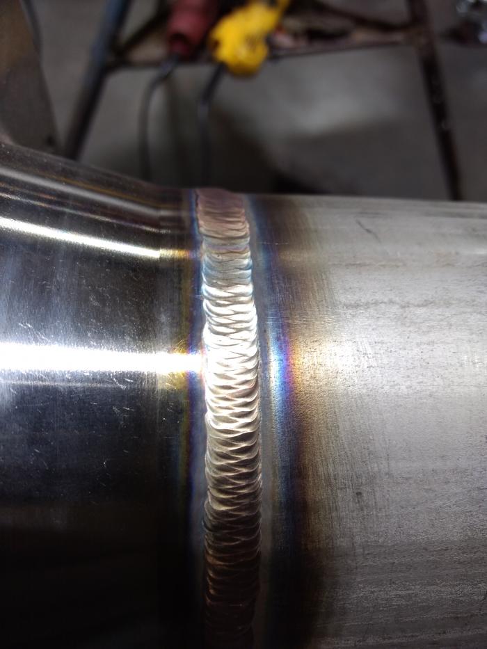

I've done about 60 of these 4" flanges in the last couple weeks. Weld a flange on, cut a 12" saddle 7" back from the weld...put another flange on. I'm not going to lie I'm really looking forward to getting the ss headers done with so we can move on to carbon, I've probably only got a few hundred hours welding stainless, and this is a 100% x-ray job for the power company, I'm just not completely comfortable with it yet (because of the x-ray requirement)
Sch 40?

Poland308 wrote:Sch 40?
Yup

Well, that is certainly impressive to a guy like me...When you weldup those long pipes with all the things coming off it do you have to figure for any distortion? Like weld the 2nd from the left then the third from the right kind of thing? I sure envy you all that get to weld all week. I am lucky to fire mine uo three times a week for paying work..(I just bought it to properly serve my boat customers as no one in the area can seem to do anything in a reasonable amount of time).

We didn't figure for any distortion in the pipe, it's there but not a concern. I bet if we Lasered the flanges the middle one would be 1/4" or so lower than the end ones... distortion isnt something that's typically thought about on the bigger stuff, especially here since install is going to be flange/ butterfly/ flange...bolts will pull it back no problem.

Donniev wrote:We didn't figure for any distortion in the pipe, it's there but not a concern. I bet if we Lasered the flanges the middle one would be 1/4" or so lower than the end ones... distortion isnt something that's typically thought about on the bigger stuff, especially here since install is going to be flange/ butterfly/ flange...bolts will pull it back no problem.
How do you start a project like that ?
Do you start from the center and use that as a reference to maintain the horizontal tolerance across the flange faces ?
Or do your comments above apply ?
