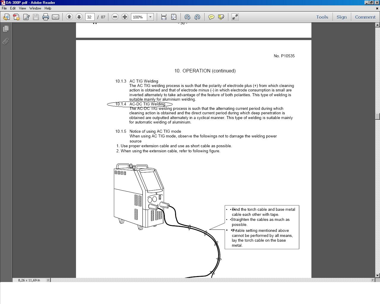

Dear Friends , I would like to make a little note here , I had a 160 Ampere DC only machine and I had to stick with it for many years before I buy an AC /DC machine .
Any way I had to weld some aluminum jobs and I tried this , I took stick aluminum electrodes Si 12 the 4043 it has 5 %Si and I weld with DC and argon
At normal flow or a bit less . The heat of torch melts ( 2 % thoriated RED 2.4mm ) the aluminum base metal the paste also melts and cleans the surface of aluminum oxide then melts the stick electrode core which is aluminum eventually it mixes with the base metal puddle . The quality of the weld is poor and you also have to remove the paste that solidifies as you do with stick welding with a chisel .
I also know that OTC a Japanese welding machine combines AC with DC so at
Tig process AC cleans for few secs then DC takes its place at this point you add the filler metal . It claims that melts a lot better and nicer than the traditional AC only machine.. So I think that Helium can work and it a very good idea that i think it is interesting well done ...

I'll have to explore that OTC machine you mentioned.
It makes a lot of sense, if set up like pulse. Say, a second of balanced AC for the cleaning, with a burst of DC for penetration? Or even a thumb-switch... AC until you're ready, press the button and feed the rod under DC?
Interesting concept.
Thanks, ESENTI,
That's what I was thinking you meant. What you just shared suggested it for an automatic (semi-robotic) process, but I can see manual uses for it, either by learning to work with the preset rhythm, or with a manual switch to activate the DC mode briefly for filler-feed.
I don't get enough aluminum work to justify a purchase, but, we're expecting a Miller SW250 back that the repair cost was too high for (we bought a new one instead), and I'll be able to experiment with it at will.
Steve , It says mostly , it can bu used in either way by a welder manualy or automation , and the machine does it itself I canot see how you can do it in a machine that has not been desined for this .Switching ac to dc is imposible while you work on an aluminum it remains only theoritcal aproach at the moment ...

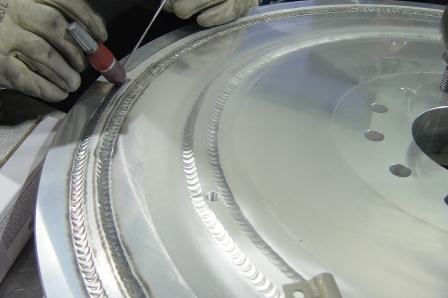

I'm jumping in a little late on this discussion ... but wanted to share a pic of some DCEN w/ helium on aluminum. Originally, TIG was trade-named HELIARC because the process used DCEN w/ 100% helium. But, today AC is the most common and preferred method for most applications ... it produces good results and argon is cheaper than helium. But, the application in this photo would not allow for any surface "etching" caused by an AC arc ... so it was welded with a Miller Aerowave in DCEN. The edges of the weld look a little smokey - but otherwise they turned out pretty sweet.
- Brent Williams Aluminum DCEN with Helium.JPG (25.37 KiB) Viewed 6826 times
weldfusion.com
That's slick, Brent!
I have access to all the (high-purity) helium I can use, and have yet to have an excuse to try this. It's coming...
I have used He/Ar, at aprox. 50/50 on HFAC aluminum for thick sections, and the difference is impressive!

Any doubts about the quality of aluminum welds done with DC and helium should be forgotten. Short runs, peen and allow to cool, repeat.
All Rodeck top fuel dragster blocks and heads are repaired with DC. Also many historic auto race engine blocks, e.g., DFV Cosworths
Pioneered, or perfected, I believe by ; http://en.wikipedia.org/wiki/Epperly
