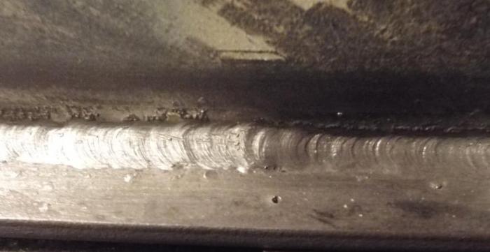

I found them a bit harder to get a consistent arc in the corner, it would happily just deposit on one face then in the root, but after practice, I got there.
The slag coating comes off a lot easier as I have a lot smoother finish as can be seen in this pic as it just tends to lift and drop away at times.
This is a stop and the next picture shows how my stop/starts (at the punch mark) are looking, (can do a lot worse)
The picture below is another stop where I am still having the same issue, I think with a slag inclusion down there in the corner.

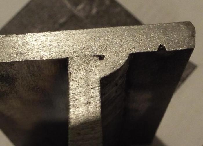

The last pictures is where I have cut my test piece at the above second stop start point, so I can see what is going on and this is a typical problem I am having. This is a bad example, or a good one of the fault, normally smaller then this but still there.
So can I ask, do you think it could be slag inclusions or leaving a hole that is not getting filled, how should I be ending one run ready for the next?

Is that cut from the middle of a weld? How many amps ? Try turning the welder up more it might be marked as 80 amps but it really looks like your running less than that. Turn it up 5 amps at a time until it feels like your about to burn all the way through or until you start feel out of control. Then post a few pics again.Things on the surface are starting to look more smooth. The slag should generally almost pop free on its own like you describe. But some slags are literally designed to to stick to the weld till it cools below a certain temp.
According to the display on the welder this was at 90 amps, but will continue to try hotter. I centre punch at the end where you see the small hole in the weld, so if I get it correct I saw through the punch mark and the base of the stop start.. I will try to get more time tonight after work.

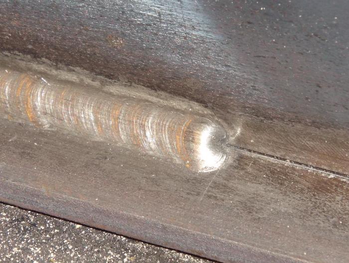

I have tried what you said and unfortunately for me has not changed anything, a bit picture heavy but here we go.
Not the best fit-up job as a bit rushed to get some time in tonight.
First run
Hole at the end after digging some flux out.
Did as suggested and started 1/2 inch in and then went back over weld and out again, also trying to keep a slightly smaller bead.
On my third bead I got it wrong, not sure if it started with some slag from running back to the start but for some reason I only attached to the vertical.

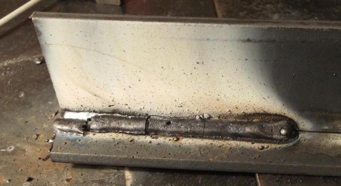

I tried running at 93 and 95 Amps but found something a bit odd, the splatter was harder to remove granted but the slag coating was no longer easy to remove, it was sticking like glue, on a separate piece I dropped it back to 85 amps and it was easy removed again. Would not have though higher current would make it stick?
For practice I used 46.30 in 3.2mm DCEP for a weaved cap, a bit rushed and missing in places, so I should take more care.
But the next picture show that I had the same issue at the stop/starts.

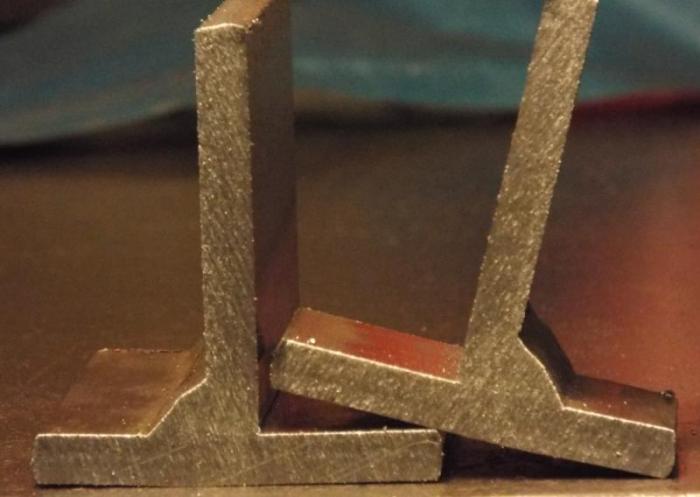

For a check I did a saw cut through the weld about an inch away from a previous cut just to see how the root was doing, and not that fantastic, nothing like it shows how the weld should penetrate into the root on most of the welding diagrams.
Any way will be in college again tomorrow, so my Fillet test piece I did two weeks ago in lesson will be cut up. Macro etched, pull test and a Nick break test, going off these test pieces I am doing at home it does not bode well.
I will be pestering my lecturer tomorrow night and taking some test pieces with me.
