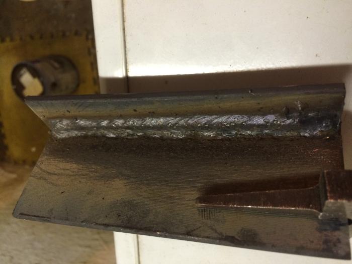

The first picture is flat 140 Amps at 50% arc force. I held a tight arc, even travel speed. The slag was very easy to remove, but didn't peel off. You'll notice that this is the second pass (I forgot to take a picture after the first pass). The second picture is also flat 140 Amps at 100% arc force. That was the third pass. When I was done, some of the weld didn't even have slag. The parts that did, wasn't hard to remove. Again, it never peeled off. So I kept trying different settings, but to no avail. So maybe another day.

Right. It's not common for the slag to peel off a fillet weld because the slag is trapped by the edge of the plate.
Once you get the tight arc, and consistent travel speed down pat., you'll have slag curling in all positions....
