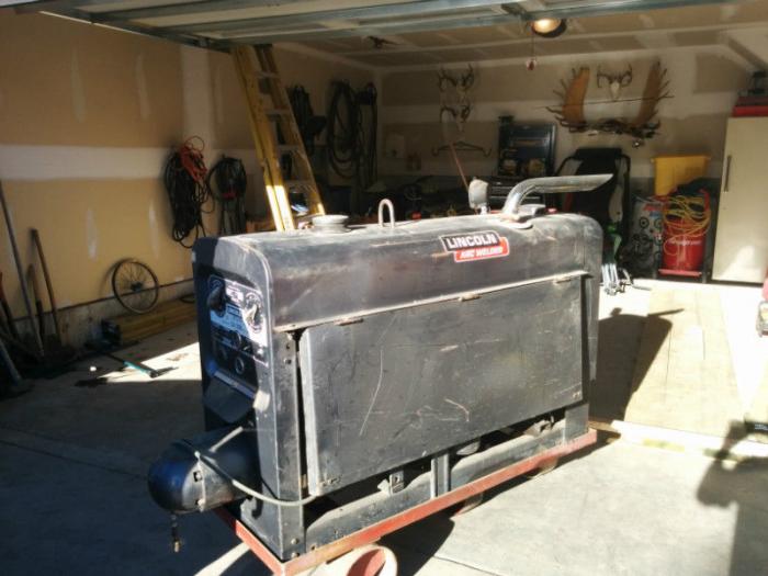

I bought an old Lincoln SA-200 on my way home today. This welder has been converted for propane.
I tried it out and liked it, so as with everything else, it followed me home.
Life is fun!
It will come in handy on the acreage, when I start messing around with shipping container garages.

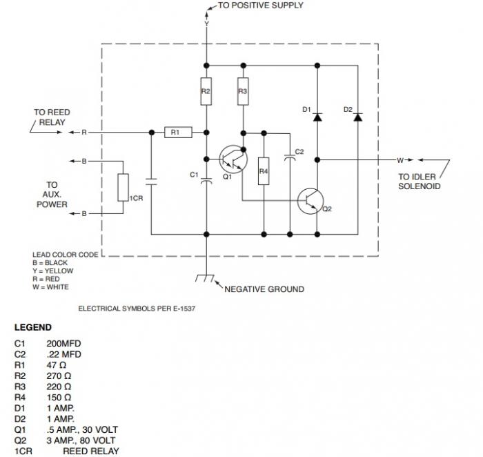

I've been looking into how to adjust the 'auto idle down' time limit for the SA-200 welder to idle sooner.
Reference: http://www.lincolnelectric.com/Assets/U ... VM224A.pdf
The following diagram shows the electronic circuit board that controls the idle solenoid.
Note that there are two reed relays used as 'idle sensors'. The Auxiliary power idle sensor is on the board.
The DC generator idle sensor is mounted off the board. These are made with a magnetic coil and magnetic reed relay.
The idea is that when current is drawn via welding or via the auxiliary outlet, current passes thru a coil.
The coil creates a magnetic field and this field is used to activate a magnetic relay as a switch.
Resistors R1 and R2 are used to bias the transistor Q1 which turns on the power transistor Q2.
Q2 will have the current capacity to operate the idler solenoid which mechanically moves the throttle linkage on the engine.
The capacitor C1 is used as the delay mechanism. Lower its capacitance value and the engine will idle down sooner.
