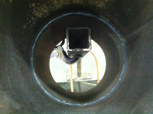

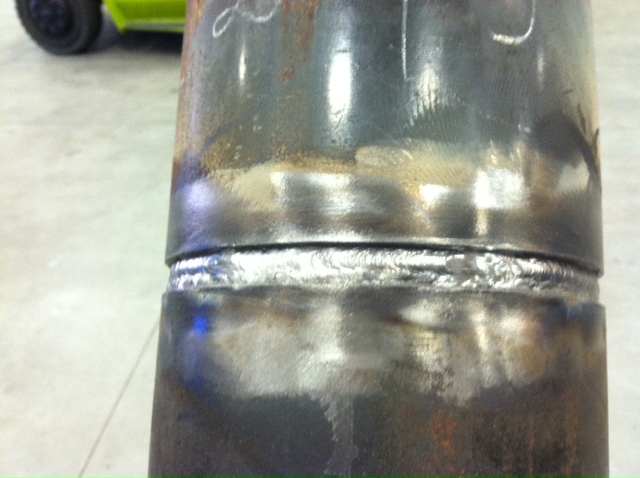

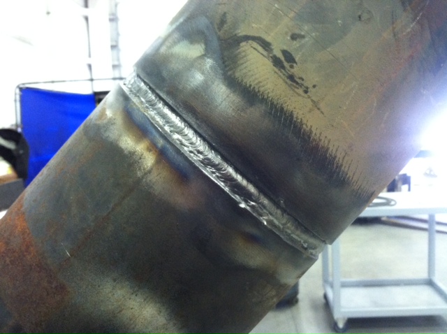

We have been working on taking various welder qualifications of late and I just finished this 6G 6" sch 80 up and thought I would share. While it is not absolutely perfect, I am proud of it, especially considering I don't weld pipe everyday. I am not exactly sure of the amps but I believe the 6010 root was around 80 amps and 7018 around 110 amps. It has been fun practicing SMAW pipe but the sad thing is we don't weld our pipe SMAW everyday, the brass wants certs for bragging rights so here they are.

Cover passes.

....and root. I am not to pleased with my left side but I believe it will be "bought".

Jake,Justjake85 wrote:Very nice! Looks good. Are you going to bend test?
Yes, we are taking around 21 tests up for bend/x-ray. Will keep you posted on the results.
Jonathan,
I think that'll pass. I don't see a thing wrong. Like you, I'd pick myself to death over details, but it'll be fine.
