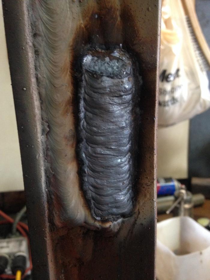

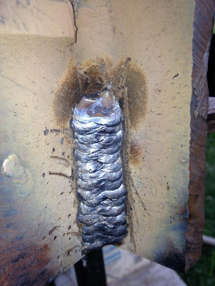

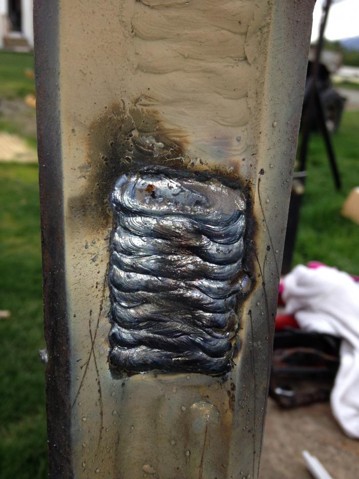

Here's a vertical up weld I just did. Still warm btw.
2" by 3/8" thick flat bar.
3f position.
Esab miniarc 161 on 115v.
110amps.
20amp breaker.
1/8" Jet LH-78 MR E-7018.
Weaving about!!
"Disclaimer"
Nowhere is this post will you find bragging or compliment requesting comments.
Don't beat me up that the weld don't have perfect wash-in, and that the toes aren't made with a ruler, and that well, oh, you didn't see that arc strike....
3f position.
110amps.
20amp breaker.
Weaving about!!
"Disclaimer"

I never tried 1/8" 7018, but I heard it was harder to control.
Is that just one pass, or was there a bead underneath?
I think it looks pretty good. I also weave my verticals, can't run a straight bead.
thanks for posting ....

mbmalone wrote:I never tried 1/8" 7018, but I heard it was harder to control.
AKweldshop wrote:Here's a vertical up weld I just did.
3f position.
Esab miniarc 161
110amps.
That was a lot of beads underneath.
I start out like this, and fill er up!!!
- IMG_5134.JPG (84.33 KiB) Viewed 2657 times
- IMG_5137.JPG (72.35 KiB) Viewed 2657 times
- IMG_5131.JPG (82.47 KiB) Viewed 2657 times
But If I was doing a butt weld vertical up, I could make a bead that big in one pass.
