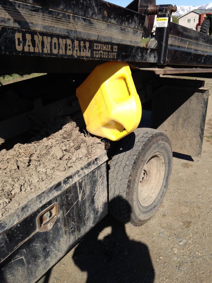

Charles_Karl wrote: "Get Lazy"
You mean like this??
- IMG_2154.JPG (152.53 KiB) Viewed 743 times
- IMG_2093.JPG (118.34 KiB) Viewed 743 times
- IMG_2094.JPG (110.09 KiB) Viewed 743 times
