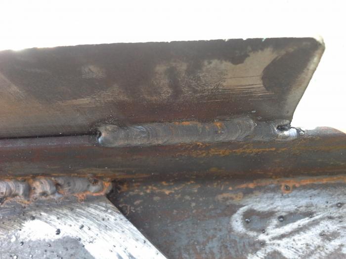

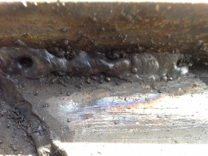

Ok so total newbie question. By no means am I a welder...pure hobby and just started. When I stickweld with 1/16 I get a good clean weld with good penetration (wheni say good I mean for me). When I use 3/16 it is a mess. High welds and just a nasty looking weld. Ill try to get some pictures loaded but any suggestions?

Hi and welcome. Since your new and your question shows it (nothing wrong with being new, we were all there at one time), I can pretty much guarantee that you probably don't have a machine that can run 3/16 electrodes. The 3/16" is F-I-V-E
times the size of the 1/16" electrode. It's also two sizes larger than the standard 1/8" electrode.
What machine do you have and we can suggest electrode sizes for you. Pretty much any machine can burn 1/16", 5/64" and 3/32" electrodes (in that order).

Ok sorry for the delay. I am using a logevity 160sx ac/dc welder running off 110.
http://www.longevity-inc.com/productcat ... weld-160sx
6013 -1/16th @80 to 90 amps
6013 - 3/16th @95 to 120 amps
Evrything is prepped to a shine.
I was told by a local welding supply that 3/16ths is what I shoukd be using but much better welds with 1/16 (well i think i get better welds)
1/16th 6013 basic steel
3/16th 6013
Any suggestions on my welding would be awesome. I am just starting with this. Aside from welding a really messy table this is the second project I have worked on.
- 1/16 6013
- 20140220_121739.jpg (41.23 KiB) Viewed 2301 times
- 3/16
- 20140220_121804.jpg (61.72 KiB) Viewed 2301 times

Two things. First as mentioned, 3/16 is way to big for your machine- are you sure they sold you the correct rod size? Second sounds like they meant to tell you 3/32, maybe you misunderstood or they gave you the wrong size themselves. The amperage you listed is correct for 3/32. However 6013 3/16" amp range, per Miller weld calculator, 150-230 amps.

Thanks for the replys. That does make sense then for what im doing the smaller rod should be fine. So there is not enough amperage to get the heavier rods to burn in.
Any suggestions on this weld then?
Too flat? Slow fast? Suggestions for a newbie.

Pause a little longer on the start to get that slag to burn out. Other than that its looking pretty good.
I would get some 1/8 at 125 amps or 5/32 7018 at about 150amps, should do a good job on you metal.
6013, in your application, is crap.
