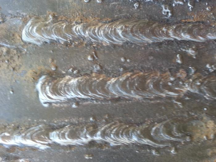

Any help or advice would be appreciated. ..
6010 at about 95 amps..

Rate of travel and arc length seem to be the main issues. Are you whipping and pausing?
camlott55
    Tue Jan 21, 2014 4:44 pm
Yes sir

Keep your arc length consistently tight and watch the edges of your puddle. That will tell you when to whip and how long to pause. BTW your beads are solid, just a little fine tuning needed.

Thankyu man I been welding now for about 5 days so any help is appreciated. .

I am in an agriculture education program in college and we have to take a few welding classes for our teaching certification and I have never ran 6010's or 6011's until I came up here. I have welded for about 10 years now but that was the most difficult to me because I didn't know that they looked like that until after the class was over. Like he said travel speed and arc length. When I teach people to weld the one thing I tell them is to watch the puddle and don't move on until it is as wide as the rest of the weld. If the puddle is as wide as the weld then it will be consistent and not as sloppy. That is just the first thing to work on. Of course there is penetration and other factors to consider but if you follow that basic rule then for the most part the weld will be uniform. Good luck.
