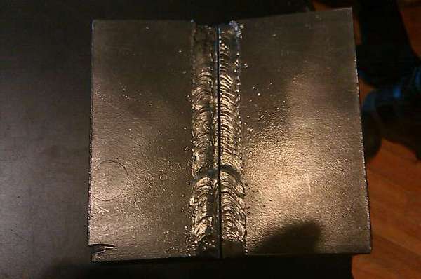

I wanted to post a couple of my results and get some feed back from some pros.
Below is My first "successful" 6010 DCEP open root v-groove butt joint. We started trying this Wednesday afternoon I got in two hours before the end of class. I came home started researching and Thursday morning after an hour of trying I produced the weld below. Since then I have made a couple tack-to-tack clean bonds.
I'm 6 weeks into my welding career and having an absolute blast.

- My first "successful" (Top) 6010 DCEP open root v-groove butt joint. I got extra credit for making the top pretty.
- 133699500.jpg (39.78 KiB) Viewed 1939 times
- My first "successful" (bottom) 6010 DCEP open root v-groove butt joint. You can see my restart.
- 133700271.jpg (31.02 KiB) Viewed 1939 times

when you get to the end of the joint, backstep about a 1/4-1/2" and that will help that crater hole. Make sure to feather yours tacks..and make sure the sparks are on the other side of the plate or pipe. Watch that keyhole...try to keep it the same size. Looks good for 6 weeks
