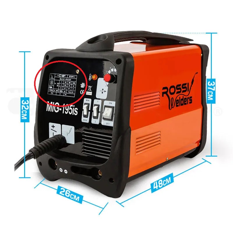

I can't even see the compliance plate clearly - is it AC only? Can you take a clear photo of the compliance plate (circled in red)?
Jack

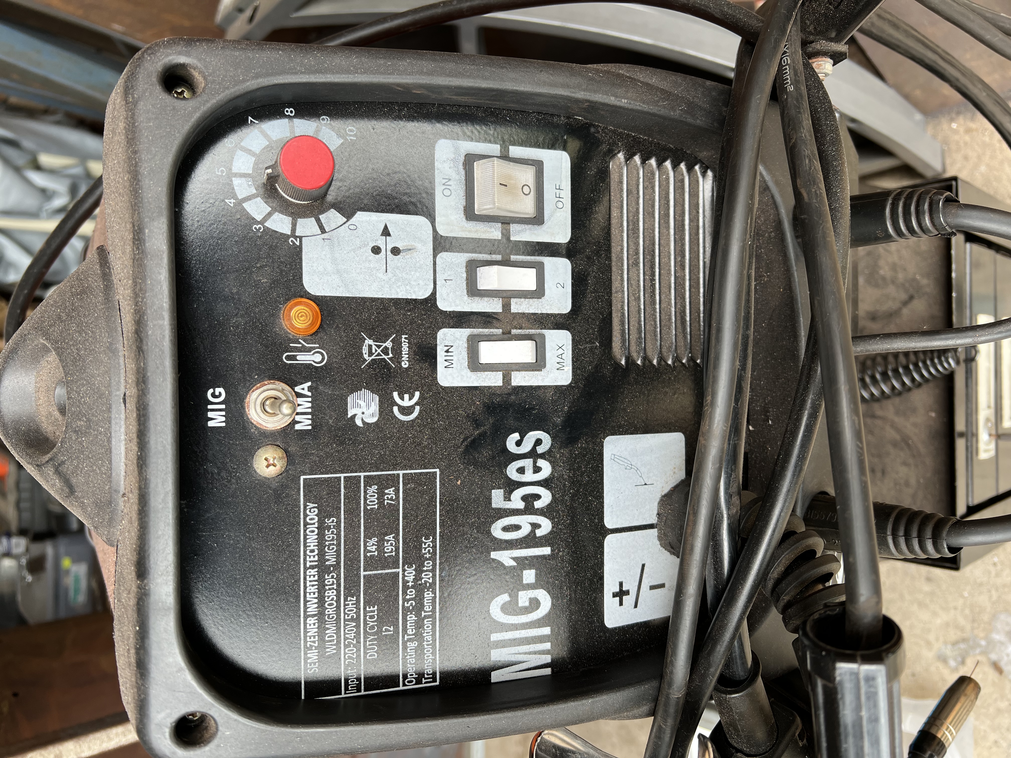

Here is the front, it has 4 settings for current, to switch between MMA and mig the the metal switch at the top

OK, that one has a switch but no proper compliance plate on the front like the other one. It must be on the back.
I gather there is no PDF manual.
This is definitely a MIG that I have not seen before and I have a sneaking suspicion that it is not the best machine to learn on. Without additional information, I would guess that it is not capable of lighting those electrodes. It might work with the AC version of them - but are they still made?
Perhaps use the 6013s

the problem is the machine. its just crap. its bad enough thats its a 4 setting mig, even worse that its hacked into being a stick welder as well.
the reason is low voltage. you need high enough voltage to run certain rods. the 7016's require a little bit more than the 6013's. i suspect your 6013's would have been running pretty marginally. i've seen the same problem with some of the cheap bunnings welders.
its one of the reasons i don't recommend fluxcore or even cheap migs.
get one of the cheap basic inverters stick welders (as long as its not one of the rip off brands) and it will be fine. even the bossweld ones will work ok.

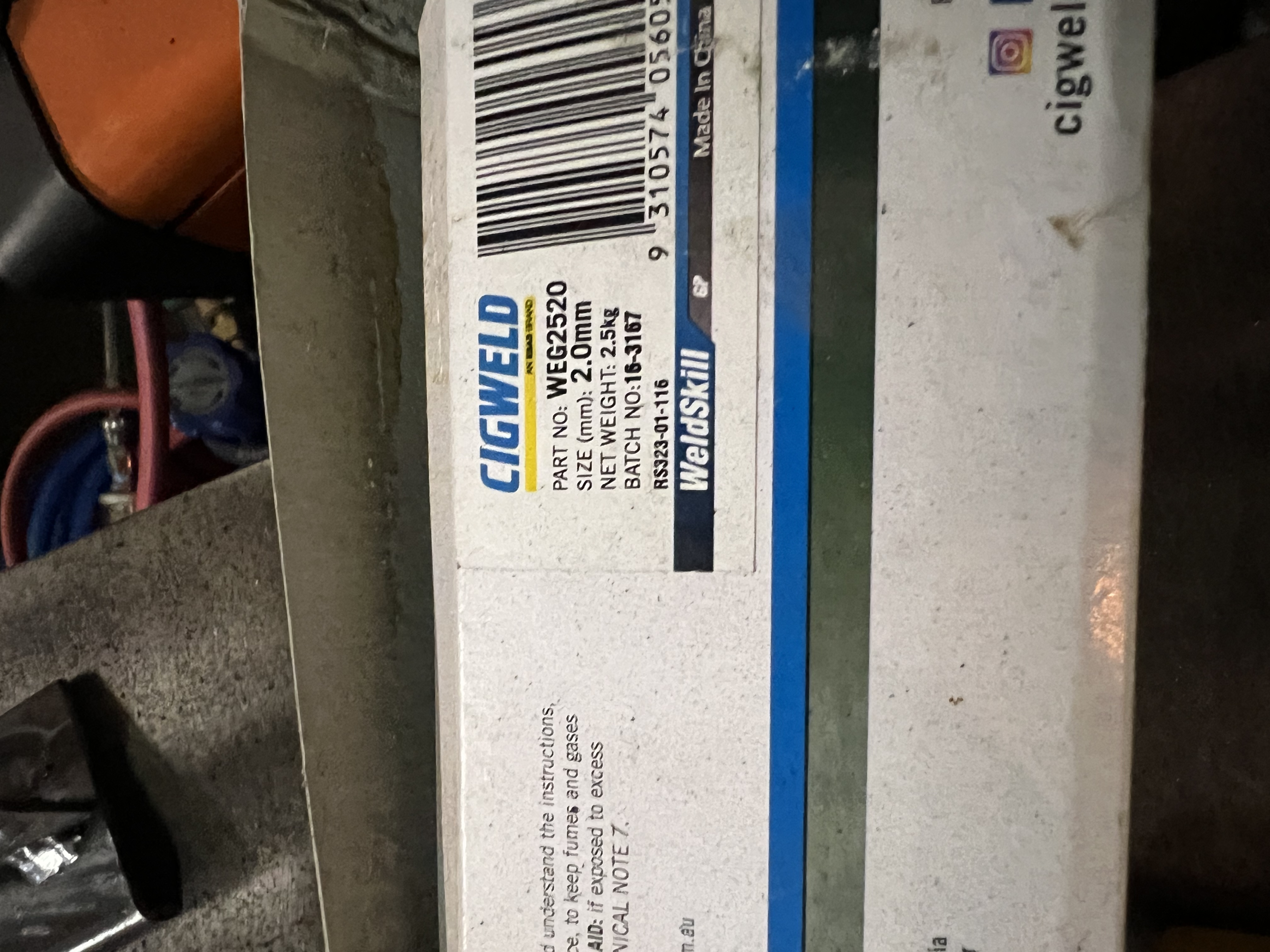

They'll be fine for size. I can't imagine the electrode holder would find them too small to grab.
Which electrodes are 2.3mm? The HYPERARC 16TC are 2.6mm and CIG GPs (6013) are 2.5mm.
Jack
Gavin
    Thu Mar 09, 2023 6:36 am
Oh it’s actually 2mm I have. I guess if they won’t go into the new machine I’ll just have to use them all up before I get it
Jack Ryan
    Wed Mar 24, 2021 10:20 pm
    Adelaide, Australia
Gavin wrote: Sat Mar 11, 2023 8:52 am Oh it’s actually 2mm I have. I guess if they won’t go into the new machine I’ll just have to use them all up before I get it
I've never had an issue with small electrodes and I doubt you will.
