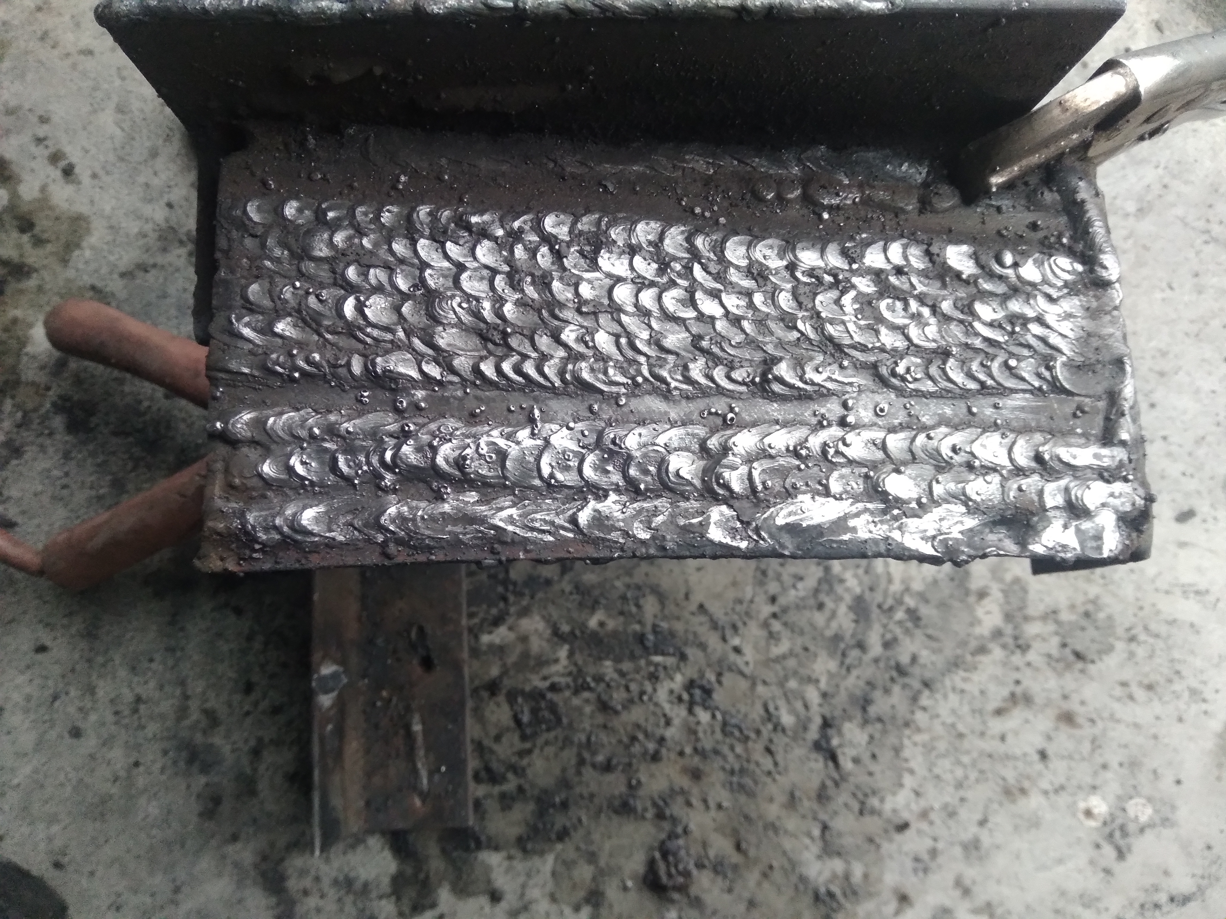

Hellos again.
And so I tripped over a box of bourbons and stumbled into my welder again, and accidentally started playing with 6010 again.
So here is my second attempt at welding 6010 stuff.
The top most collection of stuff is using a 2.5mm / 3/32 rod, at around 35-45 amps or so (analogue dial).
The bottom few beads is using a 3.2mm / 1/8th rod, at about 60 amps.
This is all on 2mm or 5/64 metal. The 1/8th rod started really heating up the bottom edge.
Is this sort of kind of how it should look? Any suggestions, obvious things I am doing wrong, etc ?
Thanks :)

So anyone out there with an inverter, annoyed that they are having trouble running 6010/6011, I strongly suggest trying this out. I picked up the old transformer arc welder for $18, so its a cheap experiment.
Why not just buy 6011 rod instead of 6010? 6011 runs on virtually any inverter. I get that you are experimenting for fun, but this is almost as useful as Oscar's water cooled electrode holder for stick welding.

Louie1961 wrote: ↑Wed Sep 22, 2021 2:00 pm
Yeah I hear ya, except cellulose rods are hard to find here in NZ, and the few places I found them were all 6010. A water cooled electrode holder is hillarious though :D
    Wed Jan 22, 2014 12:00 am
    Connecticut
Cellulose rods are over rated. You would be just fine without them.
