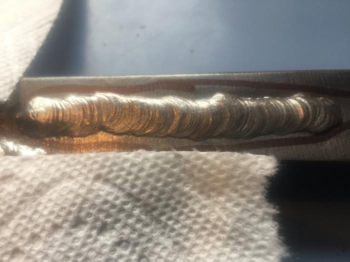

I was playing around with my OA rig the other day.
Decided to strip off the flux on a couple different rods and use them as filler on my OA. I pound them on the anvil with a hammer to loosen the flux then remove the rest with sandpaper. The cellulose rods can be soaked in water to remove flux.
The 6011 welded typically as a fast freeze.
The 7018 flowed out much nicer, easy and smooth.
Working on getting a smaller torch (Victor 315 is a bit big and feels clumsy) and some real Victor welding tips,the China ones I am using are not very good.
So don't throw those old soggy 7018's away, use them or donate them to an OA guy or gal!

One thing to bear in mind, brazing is not welding. With brazing, you’re not getting the parent metal hot enough to fuse the filler and parent metal together, only hot enough to melt the filler. 7018 rods need heat to fuse properly for adequate strength.
Now, if you’re just knocking about and doing lightweight stuff, no issue. But I don’t think I’d rely on those rods for something that needed actual structural strength.

My post was all about brazing, not welding. His first beads appear to be too cold despite the ripples. Certainly one can weld with OA, but you got to get the heat high enough to use a 3/32 or 1/8 7018 rod. ;)

Both welds were in fact welds, nice fluid puddles, admitting filler rod to the puddle with the torch flame on the back or opposite side of travel allowing the filler to melt into the puddle before advancing the flame, then retracting the filler and advancing the puddle and repeating.
The 6011 was as expected a very fast freeze, making it look like it is not penetrating but it is, try it if you have an OA.
The 7018 was interesting because of how nicely it flowed, kinda like a hot 6013, smooth and buttery.
I was using crappy China #2 tip on 1/8 plate, slow going but I was able to get the proper amount of heat in the base metal.

I believe the rod in the center of a 6010 and a 7018 are both the same grade of mild steel. The difference is in the flux. If your knocking off the flux then your just oxy welding with mild steel filler.

There are allowances for proprietary reasons on the chemical make up for different rods of the same designation. However they are so subtle they are indecernable unless your doing elemental analysis at a laboratory level. But even with these differences they have to fall with in the parameters of the rod make up for a given designation. Or else they can’t mark them with the numbers like 6010 or 7018.
I should probably add I’m not trying to be a nit picky ass. I just want people to be aware that once you knock of the flux from a rod it no longer is garanteed that it has even remotely similar properties. It may be a fine practice for a given application! But it’s not a recognized, or acceptable method for any kind of code work, or any work you may be liable for.

to add, this makes it easy to manufacture different rods especially many years ago that didn't have modern manufacturing methods. use one base metal and then its very easy to change the flux coating to get a different spec rod.
cellulose rods get their aggressive nature and fast freeze from the gas they produce from the flux.
6013 gets its nice ripples from the slow cooling by the thick slag coating.
with tig rods and mig wire you have to change the base metal used to make the rods/wire.
if you need to AO something, use tig rods or mig wire. i've known guys to twist mig wire together and use it as a rod.
