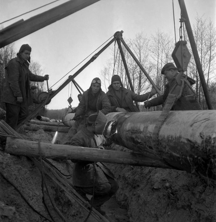

Welding of special parts of pipeline

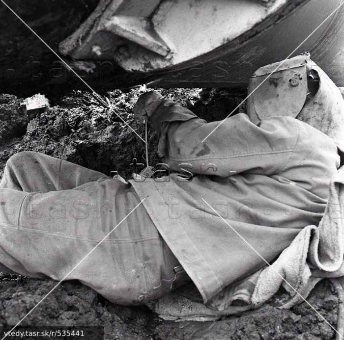

Welders must have finished their job at a time according to plan. No one was interested, if weather was bad, or if you must work in mud.

Welding in many positions...

Pipeline welding - regular day, in background you can see combination of diesel aggregate with rotary welder included inside. In foreground you can see a regular hammer - we were not using any special hammer to beat out slag from welds :)
