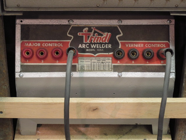

Someone gave me an old Trindl 125A about 30 years ago and it just sat around the shop getting dirty. I think it was from the 1950's or early 60's. One day I got bored and decided to see if it worked. I put a plug on it and plugged it in...it buzzed, so it must work. I replaced the old jack plug receptacles with new Miller ones, the old plugs aren't available anymore. I cleaned out the rust and dirt, painted the cover, attached some leads and it worked like a champ after all those years! I use it a lot now if I just need a quick weld and don't feel like hauling out all of the bigger stuff.

Heres a picture of it. The Miller jack plugs convert to Tweco so all my cables can be used on any welder I have.

Well now I see why you wanted a manual on it
What are all those jacks for, the amperages? Or can you actually hook up 4 welders at a time to that thing.

It's for the amperages. Major Control is the electrode holder and Vernier Control is the ground wire. I don't know why they're called that. Wires in 1 and A give you the lowest amperage, I think about 25 amps, 1 and B is about 33....and so on up until 4 and D which is the highest at 125 amps. The inside was two transformers with four wires coming off of each one and those went to the plug receptacles. Pretty simple system and it still works after all these years.

Here's a close-up of the amperage chart on the front. It doesn't give a duty cycle, at least not that I can find and there's no internal fan to cool it off if it overheats, but I don't use it that much all at once that it should ever overheat. I've got it on a 40 amp breaker which should be more than enough. It can also switch from a 220 input to a 110 just by moving a lug connector to 2 different points. They thought of everything back then!
