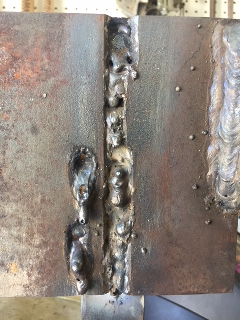

Could use some help! My flat, horizontal, and even overhead welds are pretty decent. The more I practice, the better they get. Not so with vertical uphill with 7018. I have watched plenty of videos, I've emulated what I see (CLAMS) over and over and my results still look like a hemorrhoidal nightmare. Gloopy, runny, sags of metal everywhere. The videos all stress going slow. The slower I go the worse things get. I've tried varying rod angle, amperage, travel speed. I keep a tight arc. Oddly enough, when I try going downhill (I've heard this isn't supposed to work with 7018) the welds look a lot better. But I want to do it right. Please enlighten me about what I need to change to get some good looking flat welds. Here are some photos of a plate I tried to string up.
Arbitrarily "going slow" didn't work for you with the other positions right?
Your speed is dictated by what you see happening, nothing more.
Keep it simple - make a puddle, keep going up at a variable rate that maintains the puddle.
When done, analyze the bead you made and determine what to change. Only change 1 thing at a time.
90 rod angle, don't point the tip up.

I was running 1/8" 7018 at 120 amps. dcep
I tried rod angles from 90 to slight upward push angle
I tried amperage as low as 90 amps up to 135, but mostly 120
I varied travel speed from what I've seen people doing (in so many videos) to so fast it was ridiculous.
oddly enough when I worked it downhill, I got good results.

Vertical down 7018 is incorrect.
Keep practicing, change one variable at a time.
I prefer 120-130 amps for stringers vertical up, 1/8" 7018.
Weaves I may run lower depending on steel thickness.
Keep reducing amps until you get a puddle that is too cold, then increase as you are able to control it.

I think too slow and too much amps (just a little), or and too long arc (or the rod in the puddle (?)MinnesotaDave wrote:Vertical down 7018 is incorrect.

Weaves have a slower vertical progression than stringers so more heat gets concentrated in a small area.olek wrote:Why weaves may run lower ?MinnesotaDave wrote:Vertical down 7018 is incorrect.
As a result, fewer amps may be used sometimes, depending on steel thickness.
For weaves and stringers I like to use enough amps for the puddle to wet out easily though - as a result I'm usually above 120 amps.

Vertical up puts more heat in the material. Heat rises and heats up the material above a lot quicker than when welding flat.
Welding the small gap at the rounded edge of the tubing makes it even more difficult.
I use 2mm (5/64) 7018 at 65-70 amps DCEP on 3mm tubing and if there is a small gap I use 2mm 7016 on 40-50 amps DCEN for the root sometimes followed by a second pas with 7018 on DCEP.
Welding 3mm tube with 2.5mm rods is not really a problem, but 2mm rods make it easier to control.

Vertical up with 3/32 7018 on 1/8” thick material is a challenge, especially if your inexperienced. Vertical up separates the men from the boys when stick welding with 7018.
If all I had for this job was 3/32 7018, I would run one pass vertical down. Then go vertical up the second pass. There’s nothing wrong with running 7018 vertical down as long as it’s done properly. This isn’t easy for a new welder neither. You might get it in without burning through this way.
Most new vertical up 7018 welders don’t understand that your stacking weld metal on itself. This builds a lot of heat as you work your way upwards. You need some meat for base metal to do this cleanly.

I actually teach all the new guys when they come in the shop, I remember when I was learning, vertical up was the hardest and most discouraging. my suggestion is to use 1/8 rod 3/32 imo is harder to see whats actually happening, and realistically you need to learn 1/8 anyways.
Try tuning the machine on a flat plate first, you want to get the heat so the rod just stays lit with a tight arc, secondly you may have beast luck running a corner joint vertical up, flat plate will be more difficult, the corners help kind of catch the puddle so u can see it better.
Go straight in maybe even the slightest, and i do mean slight, rod angle up.
People say hold a tight arc, this messed me up for the longest time because if you hold it too tight it will punch deeper and make the weld look saggy, i would say keep 1/8 - 3/32 arc gap, go about half the speed of flat and just trust the puddle wont drip, it will feel very unnatural at first, once you get moving you'll be able to see the puddle and make adjustments accordingly, just make sure you're comfortable and can see the underside of your rod.

On vertical up 7018 you may see the flux/slag drip away, but that’s not the weld puddle. After some practice you will be able to see the difference between the weld puddle and the slag on top.
