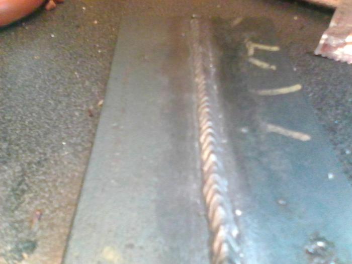

My first beads with a stick welder!!!!! Bought a 140a unimig inverter and a few CIG 6010 and 6013 rods (3/32) a had a fiddle this morning. Prepping for my first stick work for a mate tomorrow.
Old 2mp phone camera as my Galaxy died......ill get some better photos of the work when i stop being a tightass and buy a new phone (its been a week and a half now, first world problems)
I was terrified of stick welding (ever since i started making trailers a year ago with a mig, i do the sheet fab and stitching). Held off for a year because of the stigma that stick welding is super hard. Im wishing I bought a little inverter for home a year ago now. I have been borrowing my mates transmig 250i...which is not easy to lug around.
I guess all the stick welding vids on weldingtips channel really helped out. I quickly realized a molten pool of steel is a molten pool of steel...don't know why i was so worried. You might see some more home projects from me now.
- Butt Weld 6010 (75A, 4mm sheet)
- Butt_weld_6011[1].jpg (35.24 KiB) Viewed 1279 times

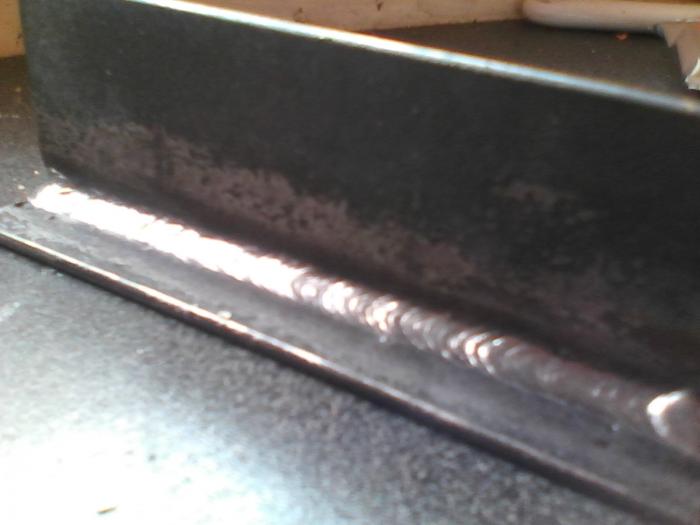

- fillet (3mm flatbar T section, 85A 6013 GP)
- fillet_1[1].jpg (30.8 KiB) Viewed 1279 times
- Fillet, 3mm 85A 6013
- fillet_2[1].jpg (37.43 KiB) Viewed 1279 times
- Experiment 6013 Whip/Pause Fillet, 3mm (3/32 85A)
- fillet_w_and_p[1].jpg (32.49 KiB) Viewed 1279 times
