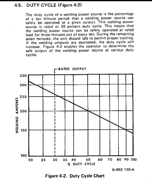

mbmalone wrote:I also have a 60A circuit. What I need is an old beat-up Chinese welder, but you can't find one in that condition that still works![]()
The Dialarc is so much heavier than the tombstone?
I wouldn't need more than 95A-120A for what I'm doing.
Yep, the Dialarc is an industrial machine and has huge duty cycle compared to homeowner machines.
Power and duty cycle = weight on old machines.
You can burn all day, rod after rod, and not slow down. Dialarc to Tombstone is not even a comparison.
(Referring to the homeowner machine, not the Idealarc round top version)
This is the chart for my '79 Dialarc.
