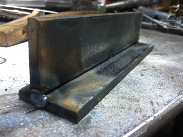

Ok take this test for what it is worth. Material is 1/4" x 1-1/2" HRFL. I cut the middle section out because I put a tack on the back so the bar wouldn't pull in so much and to eliminate a start/stop. Machine Syncrowave 200, 120 amps and 20% dig both rods. I will say this is not my best welds and almost didn't put these up. I did the 6013 first and the plate was way to hot for the second 7018 pass, but it still worked. I also did not penetrate the root very well.
My conclusion; Both held up well and took around 50 blows with a 2lb hammer to break each. Obviously when the 6013 started to yield it only went so far and just snapped while the 7018 bent to almost 45 degrees before breaking.
If my math is correct this weld should support roughly 27,000lbs. Again this really is not a real world test. To find a true tensile strength we would need even and gradual pressure. Shock loading it makes it impossible to find its true strength. Like I mentioned before, the trailer in question and most welds in general, never see shock loading like we are doing with a hammer. Also not all the welds will be put in a moment. I would like to see a nick-break test done between these two rods. This will be a more accurate test we can do at home for impact toughness.

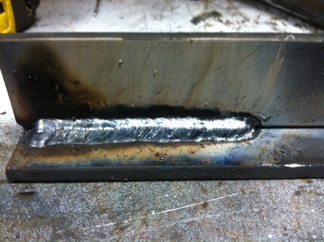

- can anyone say consistent travel speed
- Test 6013 root.JPG (143.57 KiB) Viewed 2278 times
- 6013 on the left 7018 on right
- Test 6013 and 7018.JPG (147.34 KiB) Viewed 2278 times

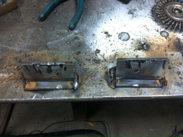

And here are the breaks. First picture the 6013 is on the right and second picture it is on the left.
I started out in a vise and broke the jaws, so I welded them to the table. The 7018 I welded down with 8010 and the welds sheared. This is why the 7018 moved to the left.

- Test 20 hammer blows.JPG (140.66 KiB) Viewed 2278 times
- Test break.JPG (142.47 KiB) Viewed 2278 times
