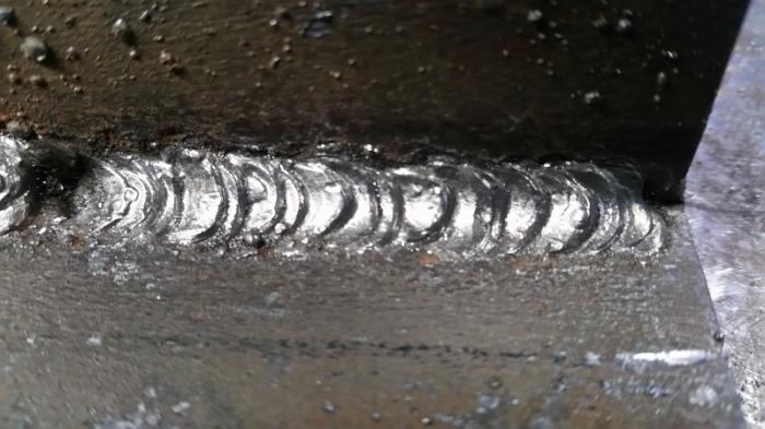

Did a little more horizontal tonight. Played with Arc Control when doing 6010 passes. Looks like 67/68 is the "sweet spot" for this particular machine. 7018 seemed to like right at 20. 6010 Root passes actually looked decent and only a couple REALLY small sections of undercut and I'm pretty sure I can eliminate them with a tick more "pause". Ran 10 passes (Stacking fillets) on each side and then cut the work pieces in half to check penetration etc. Had a small pore in an area pass number 3 would have been and I think it might have been where I had a restart. Still can't get them quite right, but definitely getting better.
After cutting, we went back to vertical. Ugh. T joints, 6010 root pass, 7018 cover. Laid down the first 6010 root pass using an inverted T motion. The first two inches were actually pretty nice (see pic) and then it all went to pot. Lost my rhythm and couldn't seem to stay focused on the puddle. Kept sticking rods on arc strike and actually managed to snuff the arc a couple times by going too deep. Not sure if I was tired/frustrated or just having an off night. Everyone in the class is still struggling with this vertical stuff.
6010 root pass, vertical, uphill

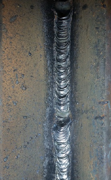

Wow! Had the proverbial light bulb come on tonight towards the end of class. Laid down a pretty decent (for me anyways) vertical uphill root pass with 6010. Other than a semi-pooched restart, I'm pretty happy with this one:
Now I need to start a 7018 vertical uphill thread. Still making dinosaur tails with that stuff...
Lightning
    Wed Aug 24, 2016 9:55 pm
Lookin good.
Now try it again with a good fixed-shade shield.
    Sun Oct 27, 2013 10:57 pm
Yep, you're on the right track now :)
Skiddz
    Sat Feb 03, 2018 2:18 am
Lightning wrote:Lookin good.
I don't know if I'd go with "good", but I think MinnesotaDave hit it right on the head below: :)
Why fixed shade?
MinnesotaDave wrote:Yep, you're on the right track now :)
And, in what's pretty typical for my life, we start MIG tonight so won't get any more stick practice unless I pull the trigger on my own machine.. At least I know what I did and can likely repeat it after a little practice and (hopefully!) improve from there.
