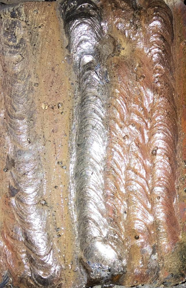

I have been practicing with some 3/32 7018 on 1/4 steel plate. I started out at 80 amps and my last bead was at 87 amps. I still think I can go a little hotter maybe bump to 90 amps. I really would like to get the slag to peel off. I have a thermal Arc 181i. Any suggestions? I know I need to learn to run a straight bead.
- IMG_1205 (2).JPG (187.84 KiB) Viewed 4449 times
Try 78 amps and turn your dig down to about 3 if you have a dig setting. Don't whip and pause just try to run a steady pull with very little side to side motion.

Don't be afraid to turn the machine up if you need to. If I were teaching you, I would have you stay away from whip and pause at this point. Do what Poland suggested, and use a steady drag with some slight side to side 'weave'. If you are 'weaving' pause on each of the toes to allow the weld to completely penetrate. Make really, really sure that your angles are correct: your work angle should be 90 degrees, and travel angle from 5 to 20 degrees. Keep your arc length short, short, short. If you are getting a lot of spatter, your arc length is too long.

Here is an updated photo. 78 seemed too cold since it was crowning too much. I ended up at 80 amps. I am not whipping but try to just do a steady drag.Boomer63 wrote:Don't be afraid to turn the machine up if you need to. If I were teaching you, I would have you stay away from whip and pause at this point. Do what Poland suggested, and use a steady drag with some slight side to side 'weave'. If you are 'weaving' pause on each of the toes to allow the weld to completely penetrate. Make really, really sure that your angles are correct: your work angle should be 90 degrees, and travel angle from 5 to 20 degrees. Keep your arc length short, short, short. If you are getting a lot of spatter, your arc length is too long.

Looking better. Even beads will come with time. Every welder you use will feels bit different. But it looks like your right about needing to go a bit hotter. Try running 3 or 4 passes at a set amperage and then bump it up 2 or 3 amps. Keep pushing it till it starts to feel out of control. Or until adverse affects like undercut or other things from being to hot show up. That will give you lots of practice and help you to see what happens when you get out of range. It's often been said by others that the numbers on the dial or on the readout are not always spot on. The practice with small incremental changes will help you learn how to set the welder based on how it is actually welding or how the material your welding on is responding. This is a skill that will transfer over to all forms of welding.

I thought I would update more practice shots. I was 90 amps 3/32 7018. The weld looked good but the slag was really hard to remove. I'm not sure why the slag was so hard to remove. I thought it was a sign that my weld is still too cold. I really tried to keep a short ARC and move side to side.
