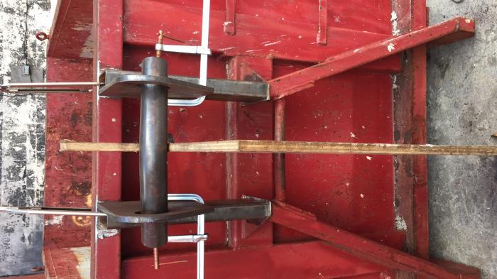

This said - while really a simple project to put together now that I've built a jig and bought a bunch of clamps - there's one part that keep causing me trouble - and I could really use some input from the experienced guys out there to see how I can improve.
1) There's a gap in these parts created by the curvature of 2x6 1/4 wall tubing edges - where 1/2" plate presses up against. Before the jig I was doing this the long hard way going vertical up z-weave....the fillet seemed to fill the gap.
Now I'm welding with the past flat on ground, and finding that when I fill the gap (1/8 7018 125-1230 amps), the slag is epic to chip out on the first pass...no wormholes noticeable on surface however....but I wonder what's going on down below in the root One the first pass in that 'valley' - successive passes at 130 - the slag peels off mostly on its own with zero trouble. What's the trick to handle this kind of situation?
2) Once the assembled part is in position - there's one more valley where the 2x6 1/4" wall tube meets the top rails - which are 1/8" or often less (!!) rolled sheet metal - and i have to go vertical up here. I back the amperage off, but all too often burn through and later have to fill that. Not having much better luck trying to deal with it using flux core mig either. Best ASTHETIC results so far using 3/32 7018 circa 80-85 amps as I can jam it in there a little better on the weave. Second pass back to 1/8 and a little more heat, pausing longer on the 1/4" of course.

- Here's the valley....those are tack welds only...heavy part so need to be strong to move it around and not lose position...made that mistake once....got me toe!
- IMG_6649.JPG (78.77 KiB) Viewed 1924 times

I've also just started experimenting with 7014 in flat position....like the way this stuff runs and serious weld deposit. Any merit to using that on the flat position valley - and 6011 (my inverter does not like 6010) on the vertical?
I only have 3/32 6011 at the moment - but ordered 5lbs of Lincoln 1/8 6011 yesterday funnily enough....

You will find that the 6010/6011 1/8 rod will run well at about the same amps that you are using to run the 3/32 7018. That's a common rod combo used on pipe work. The 6011 will be a good choice to use in the deep vee grove. I would recommend running the first pass with the 6011 and keep it a narrow bead with almost no weave. Then lay a second pass also 6011 directly on top of that keep it centered over the first pass but wider. I.e. A little weave. Then switch to the 7018. Use a combination of passes. Either use one pass with a weave to flush out the grove or a couple of stringers. Whatever your comfortable with. After that the 7018 cover pass can either be a wide weave or 2 or 3 stringers. It's tempting to weave the cover wide but I imagine if your doing it vertical up then the stringers will be easier to keep even looking.

I'm still struggling with 7018 vertical stringers....seem to get poop droplets more so than an actual stringer
My weave does end up a bit wide by the time a cover pass is on there...in some cased I've covered with a 3/32 7018 when I was beginning...easier to control and better aesthetics.
By the way when I'm doing joints in flat with 1/4 -> 1/2...I'm doing on average 4 passes (sometimes more) given this valley. Any reason why not to burn a 5/32 7018 at say 165-175amps for at least some of the beads...and cut down to say 3 passes?
Also any reason NOT to use 7014 in there was well when flat?

I can't speak to the 7014 I haven't used it much. 5/32 7018 will take a lot more amps than the 3/32 your used to. With some practice it's doable. But you will have to watch out for lack of penetration due to the steep angle of the tube to flat grove. That weld would be a good candidate for dual shield.
