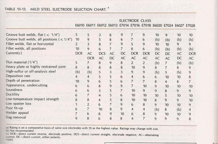

For someone such as myself who stick welds occasionally but still wants good results I am looking for advice on possibly two welding rods to use. I have primarily inverter machines. I am thinking 6011 and 7014 might be the way to go. 7018 would be in there but for the frequency that I stick weld I have concerns about dampness with the 7018 rods. Any help is appreciated.

6011 is usually the more versatile and stronger electrode. A 7014 rod is more of a "beginners" rod for the guy that has a 110 volt 60 amp cheap welder that has a repair a year. Overall, I'd go 6011 rods especially with its ability to get deep penetration and being able to weld anything on the metal (rust, mill scale).

Beg to differ. 6011 is a 60,000psi rod, 7014 is a 70,000psi rod which makes it the stronger rod.
7014 is a seriously handy rod for general non-code fab work and should not be discounted.

Coldman is correct.......First two number is pounds per square inch tensile strengh 70XX, Next number is position XX1X (all positions), last is flux XXX8 (Low Hydrogen) And all the E in front means if it has one is "Electrode" lol

I like both of those rods - 7014 are really nice to work with.
6011 run very predictably in any position and dig in when required.
7014 in larger sizes throw down big welds awesome on AC too.
AWS chart to consider:

If you are an occasional welder and want to get down to one rod, my vote would be 7018-3/32
I keep two rods primarily: 6011 and 7018, despite not having a rod oven. 7018 improperly stored cant be any worse that 7014 for strength and I like they way it runs a bit better than 7014. Nothing wrong with 7014 however, and Jody has done a couple of bumper projects with it that were featured in videos. If I have a critical project I can pick up a fresh unopened can of 7018

I would go with the guys that said 7018 3/32 , this is a hard rod to beat and I would also include 6011 in both 1/8 and 3/32.
Many times I use a 6011 and cap it with 7018 and you get the best properties of both rods.

You can cover just about 99% of your welding with 6011 & 7018. If you're not welding oil pipelines or bridges don't worry about storing rod in an oven. Buy 5lb boxes. Throw leftovers & some dessicant in a rod holder with a rubber gasket, or make your own with PVC pipe. If you're really worried, dry them out in her oven when she's not looking before using.

7018 80% of the time, 6010/7024 the other 20%.
