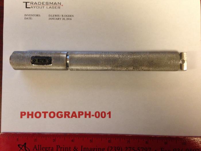

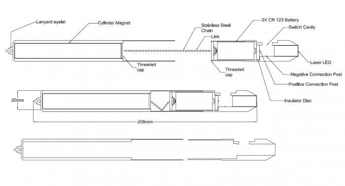

I couldn't agree more. I actually just finally received the utility patent early this year for a tool we designed that is perfect for the application you are talking about. We are currently working with a well known tool company (their tools are red) to finalize the manufacturing engineering and anticipating store shelves mid 2017. Attached is a couple of the prototype photographs in our patent documents. Our people have been field trialing it for 18 months and the fitters won't do without it. (Target retail price $22.00)
You could install those two flanges on the pup (stub) in less than 5 minutes, including tacks with laser two hole accuracy and both axis dead nuts square. Leaving your pipe stands and two hole pins in the truck.
- TLL.jpg (24.44 KiB) Viewed 2492 times
- Our first working prototype, been through hell and back during durability trials.
- image1 (2).jpg (35.01 KiB) Viewed 2492 times
