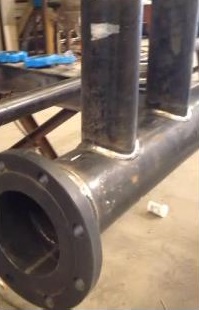

3/32 is a pretty tight gap for an 8" pipe using 1/8" rod, just run a little hotter. Depends a lot on what you are doing. For example if you are doing a WPS for a pipeline job (pipe going in the ground), you just get tight and boil the 5P down hand all the way. Powerhouse, process plant Section IX stuff what you are talking about I think, I stay right tight on the keyhole "tapping" until I start to come around to the top of the pipe (5G/6G etc). Then I might start what you call whipping, which is just adding a little distance to give the puddle a little extra time to freeze up while gravity is at work. If you see someone whipping overhead or vertical up he is racing against failure in my opinion.
Here is a 6" I set up with an 1/8" Gap / Nickel Land - 1/8" 6010 at 85 amps (Trailblazer). Nice and steady just tapping the keyhole, no whipping. One thing I didn't understand when I was young that what was the big deal over this land thing. I was my dad's and grand dad's apprentice and they would give me hell more for an inconsistent land more so than a nickel or dime. What ever you choose in land and gap take the time to make sure it is the same all around the pipe.
When welding pipe for 2000+ psig MAWP, perfect is every time, not just test time.
