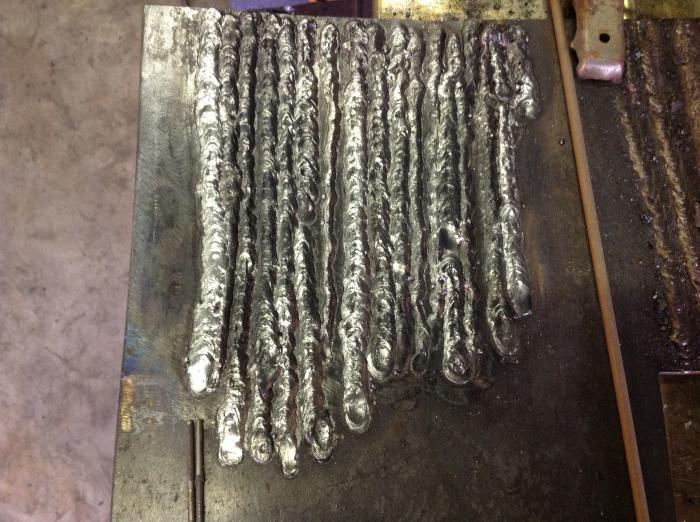

7014 is the answer to straighter lines for this beginner. I had the 1/8" set at amps lowest 115 and highest pegged to the 140 DC mark on the welder. Ran the majority around 135. This is DCEP. I tried the fixed shade 10 and love it. I have to raise the hood a bit to see where my electrode is, but if that can be considered an inconvenience it is well worth it, i can see the soapstone marks with this shade 10. I did forget to flip the hood down once before striking that was an eye shutting experience
Thanks for all the tips guys. Please have a look at the pics below and critique please and thank you.

When I need to keep a straight line I use a small pocket scribe and straight edge. Sometimes even when capping a pipe weld I'll use a wrap around and a scribe to keep a reference for my cap width. It stays in place while the soap stone melts away. Aging eyes are fading faster than the soap stone for me and everything keeps getting harder to see and keep in focus.

Hey Len, if it weren't for cheater glasses i could see nothing up close. What do u do, take the straight edge with a heavy duty scribe type tool and scratch a line on the metal? U don't leave a straight edge on the plate far away enough so it is not welded on the metal itself do u? I have contemplated tack welding a couple of straight metal pieces ,onto the plate to use as a sight guide, shooting for the middle of the two guides without welding them to my practice plate. Wish i had my pre-40 year old eyes back
. I did find that the shade 10 lens did help me see the puddle and the soapstone better than my AD helmet, after i practiced with the 7014's yesterday i tried some 6011's and i wondered off course again.

I just scribe a line next to where the weld is for a reference, maybe an 1/8" away. Not real deep so I remove the line with a wire wheel on a grinder. On pipe I do both sides so I have a reference for the width on the cap to keep it even the whole way around.
All this is only if I'm going for pretty and most days I'm not so good enough ends up just that. I don't weld all day everyday at my job so I get out of practice. I find that when I have to do a lot of pipe welds that it starts to become easy to keep a consistent width.
