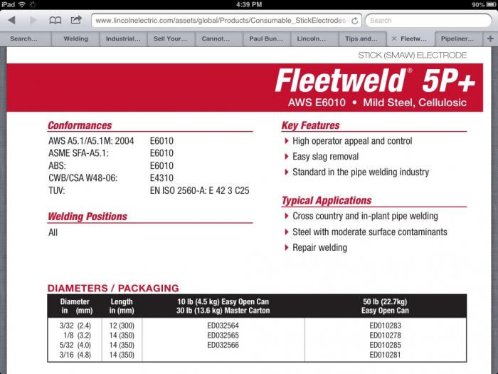

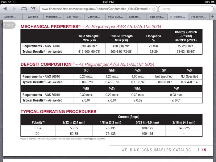

hey thanks for sending that picture. you have to wonder if they use that label for everything they manufacture. if they manufacture anything anymore.
thanks to the other guy also for making my point about the 6011. instead of performing multiple levels of testing with multiple manufacturers of welding rods as suggested. just buy some 6011, it's childs play; isn't that better?
that labeling regarding tensile and yield strength is suspect.
http://www.lincolnelectric.com/en-us/su ... etail.aspx
    Sun Oct 27, 2013 10:57 pm
I was puzzled by the label as well.
So I pulled up the Lincoln 5P+ sheet and the as-welded numbers are similar.
It also lists running them DC- although I've never actually heard of anyone running other than DC+
