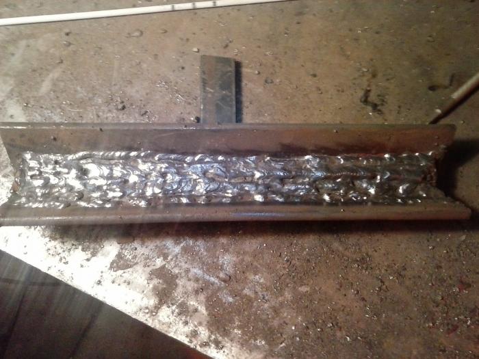

I'm in in in my 3rd month of a 2 year combo welding program at the ComCol. Been through flat, horz, vert, but this overhead fillet welding is killing me. (Yeah yeah I hear you guys laughing)
Just something about the whole drag-feed upside-down I guess. I found out I was running way too hot, 3/32 at 95A. I figured I needed more arc-force to "blow" it into the metal. But I was wrong, 80A seems to work better. Next semester we move onto structural certs, so I hope I get the hang of this before Christmas.
Instructor said, hmm looks like oatmeal...keep trying

Remember to keep pushing up, push up so that the flux lightly touches the metal and keep it there.
If you don't keep pushing up, your arc length will alternate between touching and long arcing - remember that you are feeding the rod into the metal.
Btw, I run with the flux touching because I'm not steady enough to keep a 1/16" arc length - so I go a couple more amps and let it touch.
Make sure your amps allow you to run this tight without sticking.
I like 100 amps on 3/32 7018 for flat and overhead (and vertical if the metal is heavy enough).

I notice that the "oatmeal" look of my overhead beads are getting better. Just time under hood. :D

I am going a bit off topic here, but I hope the instructor said more to you than "hmm looks like oatmeal...keep trying". After that much time in class, you should be able to identify WHY you are getting the results you are getting (either good or bad) and WHAT you need to do to fix it!
Just looking at your welds: You have 'skips', and you are rushing. Your beads are narrow. I would bet you are not comfortable or in anything resembling a good position. You need to let the puddle fill out; work on puddle control.
Sorry! Only trying to be constructive! Make sure you are in a good position to where you can look into the arc and see the entire puddle. Watch your rod angles (it helps if you have someone else help you check and make sure you have it right). SLOW DOWN! You WILL get this!

Yeah, I was horribly uncomfortable. He had me welding with my arms cocked all weird and the rod coming 90 deg out the side of the stinger. Another student suggested I hang the whip up and have the rod come out the tip of the stinger. Night & day!

prebres wrote:Yeah, I was horribly uncomfortable. He had me welding with my arms cocked all weird and the rod coming 90 deg out the side of the stinger. Another student suggested I hang the whip up and have the rod come out the tip of the stinger. Night & day!
Something else that helps is to throw some extra lead looped over your shoulder so that it rests there and you are not holding the weight of the lead up off the floor by the electrode holder. It might not be that bad with some small cable, but the company that I used to work for had 0000 cables on everything and it was heavy.
