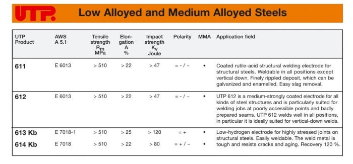

Greeting, I'm doing a patch on my truck frame. Welding store recommended upt612. What do you thing 140st at 60 amps dc+. My patch will be 5/32 cold roll. I want to do a vertical pass on each side and call it a day. What do you guy's and gal's think.

I wonder why they recommended a 6013 rod?
What size did you buy?
- image.jpg (40.31 KiB) Viewed 1476 times
I'd recommend a 3/32" 7018 at 90amps DC+.
6013 on a frame is like an accident looking for a place to happen. The guy at your LWS is an idiot
Buy a handful of 3/32" 7018. You'll be glad you did.

Thank you for the quick replies. 3/32 is the dia. On the upt612. Also if you mouse over the pic, you can see what I am up against. I'll be cleaning up everything before the patch. It's only one spot on my truck. But super rusty. Ok 7018
Yeah,
You might try 80amps.
About 45deg uphill push, and move the rod straight up the joint.
That's how I'd do it anyway.
Let us know how it turns out.
John
John

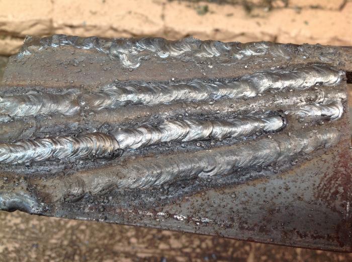

... Also been practicing my welding.
- image.jpg (79.44 KiB) Viewed 787 times
