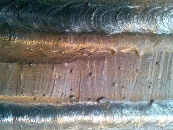

here are some pics of 6010 and 7018 with the tombstone. KEEP IN MIND I WAS VERY NEW TO WELDING WHEN I TOOK THESE HAHA...probably about 2 months in...
I had a welder on my job who was willing to share his time and knowledge with me and he helped to get me started. im still a beginner but I don't even care to guess how awful these would have been if he never took the time to help me. thanks Mike I owe ya brother...

- some 6010 done with my tombstone when I first got it
- CAM00635.jpg (58.38 KiB) Viewed 3345 times
"The Plumber Protects The Health Of The Nation"
here's some more ac/dc tombstone shots. practice 6010 flat and try to get that down first. I never got great results out of position, but then again this was my first machine and im obviously not someone who has been welding for 30 years. I'm sure otto or some of these other guys could make 6010 look good on a harbor freight 80 amp inverter haha
- 7018 weave
- 643.jpg (95.28 KiB) Viewed 3343 times
- memories....
- 620.jpg (39.29 KiB) Viewed 3343 times
- some 7018
- 655.jpg (74.74 KiB) Viewed 3343 times
- some 7018 and 6010...not my best but not my worst either haha
- 652.jpg (116.96 KiB) Viewed 3343 times

I need to post some pics too, but I am embarrassed, as I have a lot of problems with straight lines and poor eyesight. I don't know if I will ever be able to be a welder. but I just keep trying until someone I trust finally just tells me to give it up.
I think those beads look good, I can't make my beads straight like that. I am also most concerned with 6010, like this. I wish I had a welding mentor. I went to school for welding, but they didn't care much at my school.

I've owned a couple old tombstones and still have a Century AC/DC buzz box in the garage - the DC amps are too low so I always ended up running them on AC.
In my opinion you'll be a lot happier running 7014 1/8" rods on AC while learning than you are currently while trying to run the DC rods.
I used 7014, almost exclusively on AC, for many years before I upgraded machines.
I still use them sometimes and they are so smooth it feels like cheating
Switch to some fun rods to run and enjoy your welder

AK is right. Not all rods are created equal. Cheap machine + low to mid range rods = problems... break loose and get some 5p or 5p+ from Lincoln. You will be amazed. The 5p+ has been engineered to be a more user friendly 6010. Try it out. Buy the 1/8 and give it a go.
And post pics of your welds not your rods haha! These guys can be very helpful. Ive watched them give countless opinions and help us beginners out.
Dont worry if theyre not the best. In my 1st 6010 pic you can also see the back side of my first 6010 open root attempt. And it couldnt be any worse
We all started somewhere and even these guys giving advice weren't born with a stinger in their hands. Everyone is here to help. Post them pics brotha

I tripped over a doorstop I had made in the past. Just to show that I had been practicing, I took a picture. This is not today's practice. I was using mixtures of rods and every little piece of rod I had left was burned, just for arc time. I know it's crap. I wasn't trying to have this critiqued. I will start a new piece, today. These were all made with the tombstone, but over different days. I would like to have my new piece critiqued and will try to take photos at different amperages for comparison. I will also show the same run with a different rod. Like a good rod and a bad rod.
