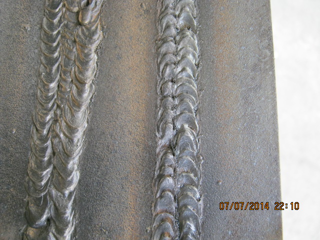

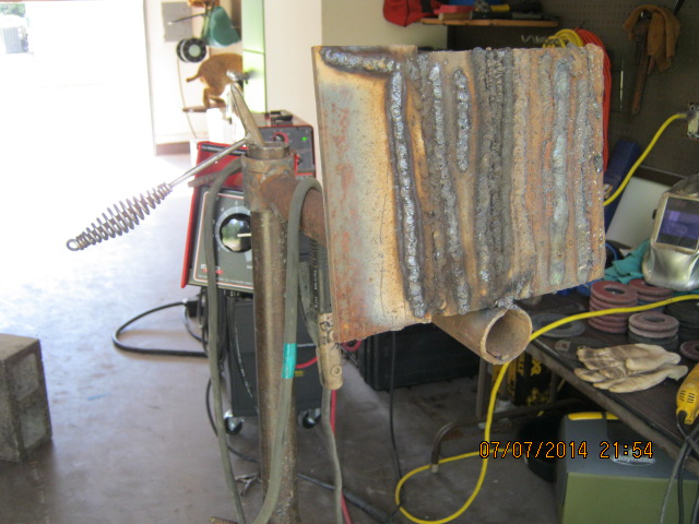

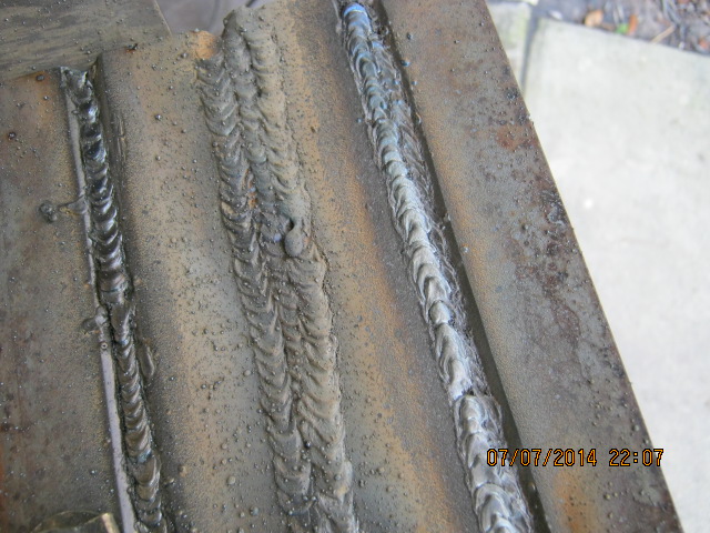

LOL...Thats wat I like about this crowd....Always something to get ya laffn or thinkin...J..I know that was crapy postin with no pics....But I was amazed at this thing...The XMT's didnt run like this...But it is "painfully" obvious I need to get as good as this machines capabilities
....Maybe its the remote???I LIKE it...lmao...Dave, Arc, Jonathan,John..all talked it up...NOW i see it...MAN...Any way,ripple spacing, reinforcement consistancy,Building a base line from neutral settings,insteada twistin the knobs just to see what happens ...LMAO...My first attemps were 3/32 6010 on 3/32 land & gap @ little over 50-40 by the dial(digital would be nice)..I know ARC..getta 350...lol..Second wasa 1/8 6010p+++ 1/8 L 3/32 gap @ 90-70...from soft to crisp on arc force...So without further adooooo...first shot

Mike,
It might just be me, but these Invertecs like Jet LH 78 7018 better than Excailiber.
Expecially vertical up.
FWIW.

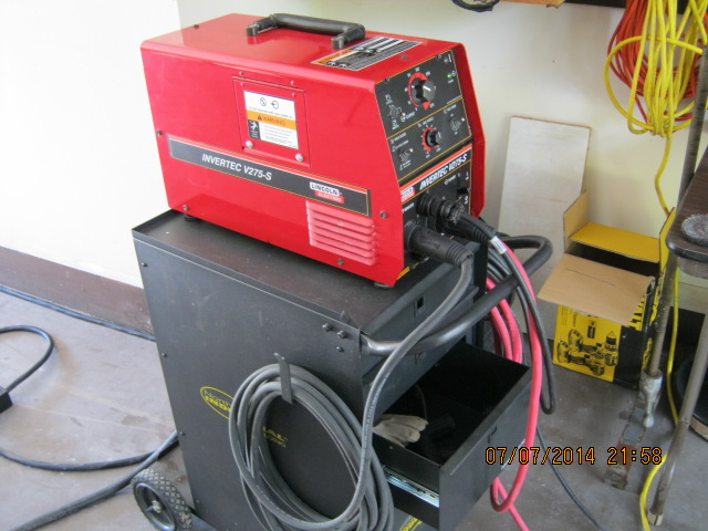

O.R. Knife edge..3/32 gap @ 90 amps(on the Everlast)..3/32 excaliburs out with the lincoln @ 65-75 ??? YEA..A readout would be great......BTW>>> Does anyone know where you can get the magnets that hook to the remote box????..I've google everything..No luck!!!...ARC...I'd bet you know where to get um?????

Don't worry, the lack of numbers bugged me the first day too - after you get used to it you won't care anymore.mike boyer wrote:O.R. Knife edge..3/32 gap @ 90 amps(on the Everlast)..3/32 excaliburs out with the lincoln @ 65-75 ??? YEA..A readout would be great......
It's more about what the puddle looks like and how it's behaving than what the numbers say on the dial anyway

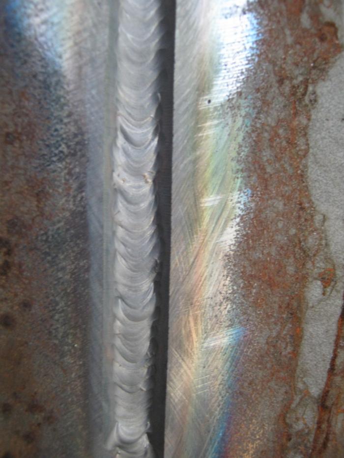

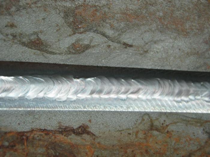

Now wouldn't that be cool...Get ta see a face insteada typing...There's plenty for everyone jonathon...Yea it's the puddle for sure...in position..LOL..The box makes it nice Dave.....I'm still just playin wit my new toy.... I LIKE IT....Here's todays show n tell....Knife,1/8 gap..1/8 70s6...@ 85A....SPAZZIN the cup...I will get it tho.....some way outa shape bevels & gap..just Because....Thats life...This is flat Tig... for the 3rd attempt i wasnt gona get to crazy...LOL

Lookin good Mike

Yea..Im wantin to find the magnets that go in um..Or mount to the back....not havin to "fish" for it would be a plus for sure....ANYbody know where to get um???

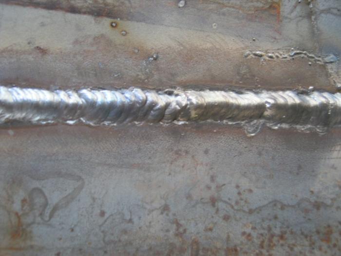

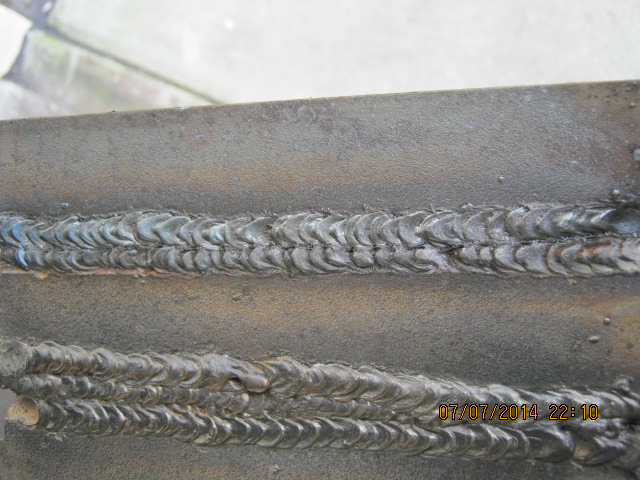

Ok...6 in the mornin...I couldn't stand it anymore..Had to go to the garage & do vert O.R. on 3/8 plate..3/32 land 1/8+ gap..110 amps ...1/8 70s6 filler.....hot passes were 3/32 @ (50-60???)......I was happy bein the first one I'd ever done.....Did I mention I REALLY LIKE THIS TIG...LOL..Cant wait till my flex-lock gets here & plug it into the 275.....HAHAHHAHAHAHAH.....Awrite guys ...Pick it apart...See if we're seein the same things....The cover,I was tryin different things...Hence the different profiles....
