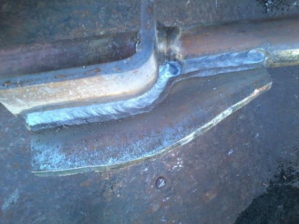

Heck, I pretty much like all the different rods for different reasons.
For sake of argument here is a 6013 three pass weld I did on AC for a set of light tractor bucket forks.
Ran outta mig wire and the 6013's my kid was using was all I had left - too impatient to drive to town and burn an hour
Not perfect, but pretty normal weld for me.
Here's the thread: http://weldingweb.com/showthread.php?28 ... highlight=

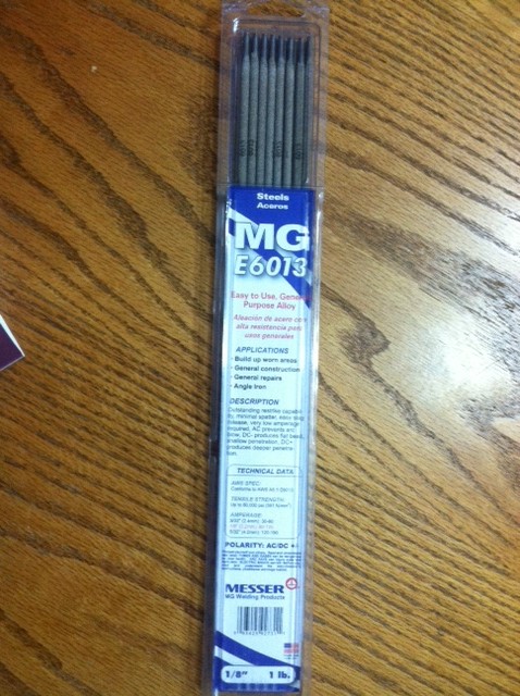

I will not be able to get out and weld for a while, but here is what I bought for this "test". I did not want to invest in a 50lb box of Lincoln and this will represent what most will have in the garage anyway. Now to find some material....
- Messer 6013.JPG (123.77 KiB) Viewed 6133 times
I was just gunna say looks like its gunna shatter, and possibly de stabilise the indo-china alliance . Not to metion the time-space continuum. Evil things they are. lolz
mick
mick
weldin mike 27 wrote:I was just gunna say looks like its gunna shatter, and possibly de stabilise the indo-china alliance . Not to metion the time-space continuum. Evil things they are. lolz![]()

Ha! Obviously the world will end since I used 6013 for those forks. I even load checked them with an SA-200plantwelder wrote:Nice job. What make of rod and current? Of course, you know it'll never hold.
135 amps AC with my 1963 Airco 300. I liked them better on AC.
I no longer have that box so they could either be Lincoln, Forney, or Washington Alloy.
I have some Hobart stuff right now that welds just as nice but throws sparks like mad!
I noticed the Hobart flux coating is much thinner than the other stuff was - that flux was almost as thickly coated as 7014 rods.
My 7018 Lincoln rods don't spatter hardly at all as a comparison.

Nah, 6013 vertical is easy too - heck just look at my tractor fork weld again, now I did it verticalBill Beauregard wrote:In my "All i got is AC" days, I used a lot of 6013. Both then and now I believe a good weld is stronger than a bad weld with strong filler. In those days I avoided vertical welds. It's hard to beat a horizontal weld with 6013. If it has anything near 60,000 PSI tensile strength, that will cover most needs. After getting my first DC machine, I gradually switched to 7018, and vertical up didn't seem so hard. As Howard, the welder who builds all equipment at the pellet mill describes it; You have to make a hole to anchor the filler, then cross the puddle to do the same on the other side. A low penetration rod can't burn the needed hole.
- image.jpg (81.98 KiB) Viewed 2371 times
Yeah and now it looks worse - from now on I'll just take pics of the backside and say that "from the heat tint you can see how good the penetration is"weldin mike 27 wrote:Well you turned that on its head....
