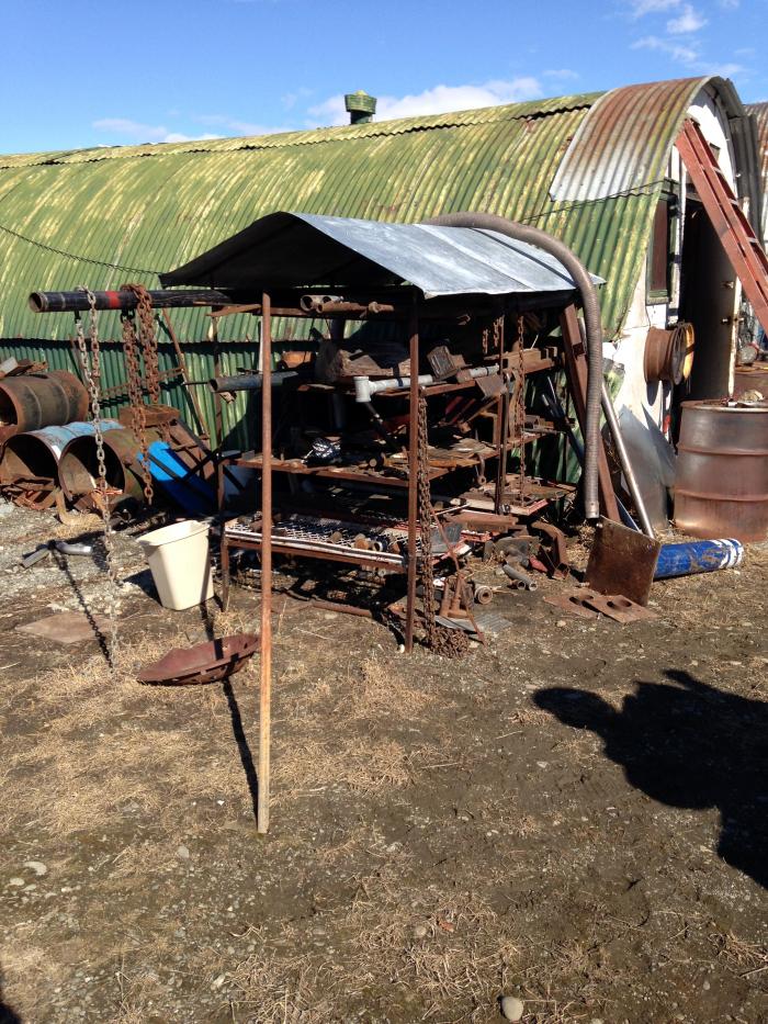

It will hold....I thinkSkillets365 wrote:
7018
Skillets,
That weld will hold as long as that metal lives.
I welded up this rack years ago, with 3/32 6011.
It was a bent up rack that I gave $5 for at an auction.
All 1x1 1/8inch thick angle....
Smoke those 6011 beads in, about 70amps
Been standing there for years with probably 1,000's of pounds of steel on it....
Has gotten 6inches shorter though.
