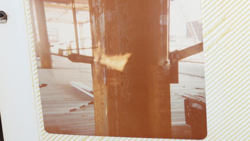

many years ago i was working on a high rise and the welding inspector required me to preheat. not knowing any better i asked him why this was necessary. he took the propane heating torch out of my hands lit it and ran it quickly once or twice over the column i was getting ready to splice. the water that ran off and beaded up on the surface surprised me even though it wasn't visible.
On cold steel, all that condensation came from the flame itself. The vapor from that propane flame is CO2 and H2O (water vapor), and the water instantly condenses on the cold steel. You didn't melt some invisible film of ice. He impressed a young you with his demonstration, and you did it his way.jwmacawful wrote:many years ago i was working on a high rise and the welding inspector required me to preheat. not knowing any better i asked him why this was necessary. he took the propane heating torch out of my hands lit it and ran it quickly once or twice over the column i was getting ready to splice. the water that ran off and beaded up on the surface surprised me even though it wasn't visible.

it was summer.Otto Nobedder wrote:On cold steel, all that condensation came from the flame itself. The vapor from that propane flame is CO2 and H2O (water vapor), and the water instantly condenses on the cold steel. You didn't melt some invisible film of ice. He impressed a young you with his demonstration, and you did it his way.jwmacawful wrote:many years ago i was working on a high rise and the welding inspector required me to preheat. not knowing any better i asked him why this was necessary. he took the propane heating torch out of my hands lit it and ran it quickly once or twice over the column i was getting ready to splice. the water that ran off and beaded up on the surface surprised me even though it wasn't visible.

column pre-heat. summertime.
- selected pics 2012 012.jpg (34.42 KiB) Viewed 3877 times
Pass your cutting torch closely over some 100* steel, and see the band of water droplets on each side of your path. My point is, the water didn't come out of the steel, it came from the flame.

It is my understanding that the water droplets on the surface of steel do not come from the steel itself.
The water condenses on the surface much like it does on a pop can.
The water can come from the torch, the air, or a combination of both.

I was preheating some 1/2 inch alum plate prior to TIG welding it when I notice moisture forming on it. I was wondering where in the hell that came from? Now I know. That's funny.

who said the water was inside the steel?? this is SURFACE water that is called condensation. it is the same principal as putting cold beer in a warm glass. the droplets that form on the outside of the glass isn't beer. the glass isn't leaking. same principal. raising the temp of the steel above the dew point prevents the water that is on the surface of that steel from condensing. the only one pulling my leg is you. what a joker you are!!

The condensation on your beer glass came out of the air, not the glass, to use your analogy

now you got it. the same way the water is condensing on the steel. from the air. i knew if i used beer.....Otto Nobedder wrote:The condensation on your beer glass came out of the air, not the glass, to use your analogy![]()
