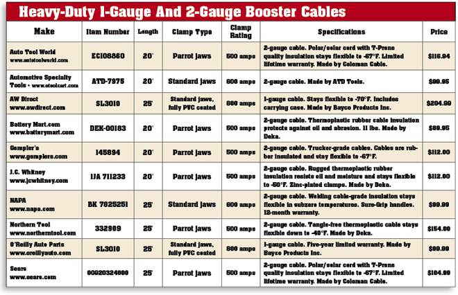

    Tue Jun 26, 2012 8:05 pm
If your not liking the price of replacement welding cables,
then go to your local auto salvage yard and look for a set of heavy duty, used jumper cables.
Jumper Cables.jpg (199.87 KiB) Viewed 1072 times

Thanks WS for the info chart. Downloaded and saved for reference. I actually have a set of very heavy duty cables that were damaged when two of the clamps were driven over that I was going to scrape or repair. I will give them a hard look and see if they might work. I'm thinking they might just be a bit short but they also might work until the welding equipment fund grows. Thanks again, Bill
